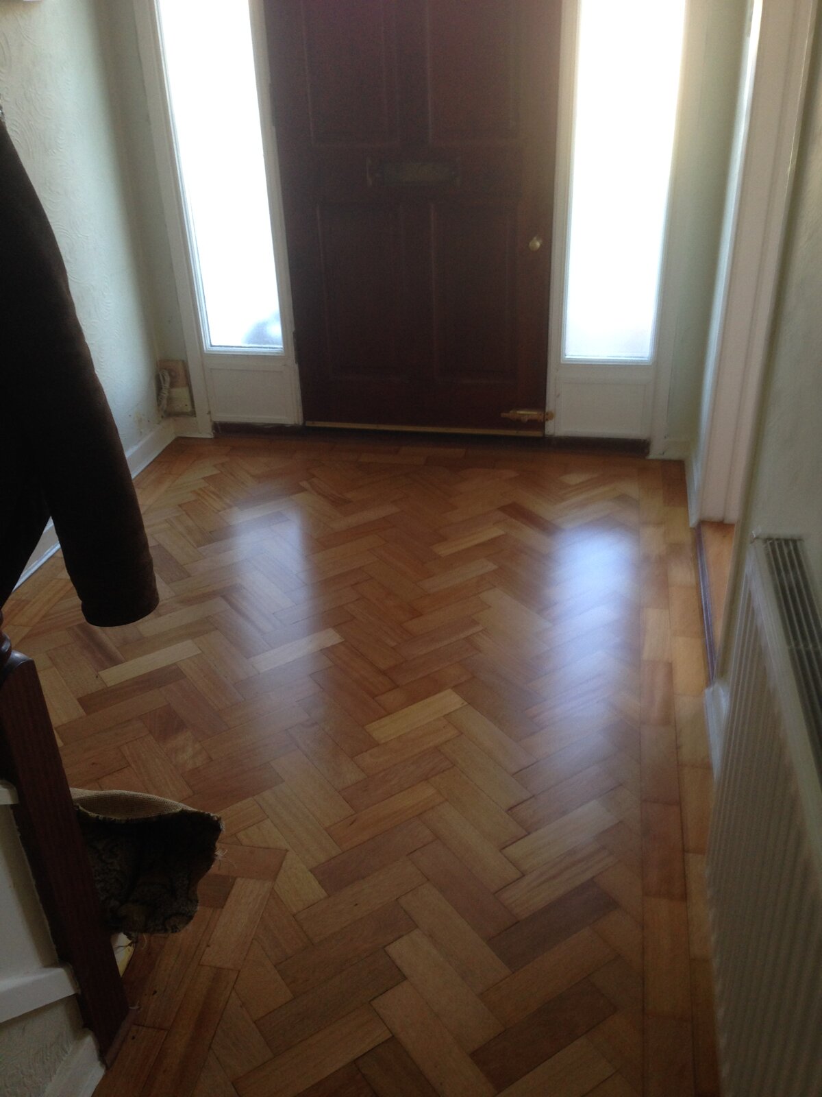

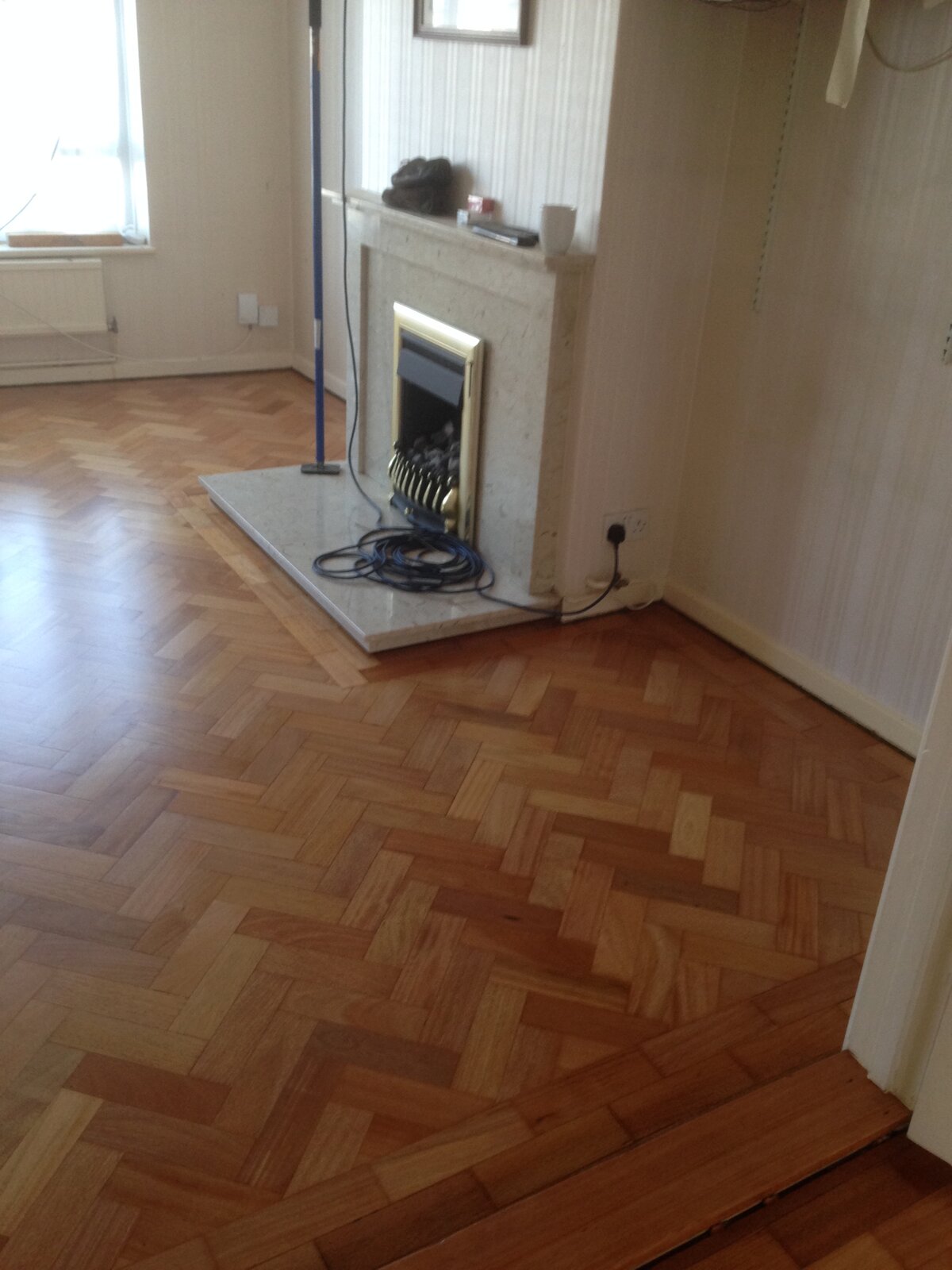

staves or blocks?
My parquet is young and groove blocks, laid in herringbone. Only the edges are at risk from damage unless you go nuts with a hammer.
Finger Parquet was cheaper and generally used more recently.
It's just bits of wood laid side by side into tiles.

Actually I'm not sure if it is staves or blocks - what's the difference?
It is laid herringbone and there are groves to connect each block / stave together.
