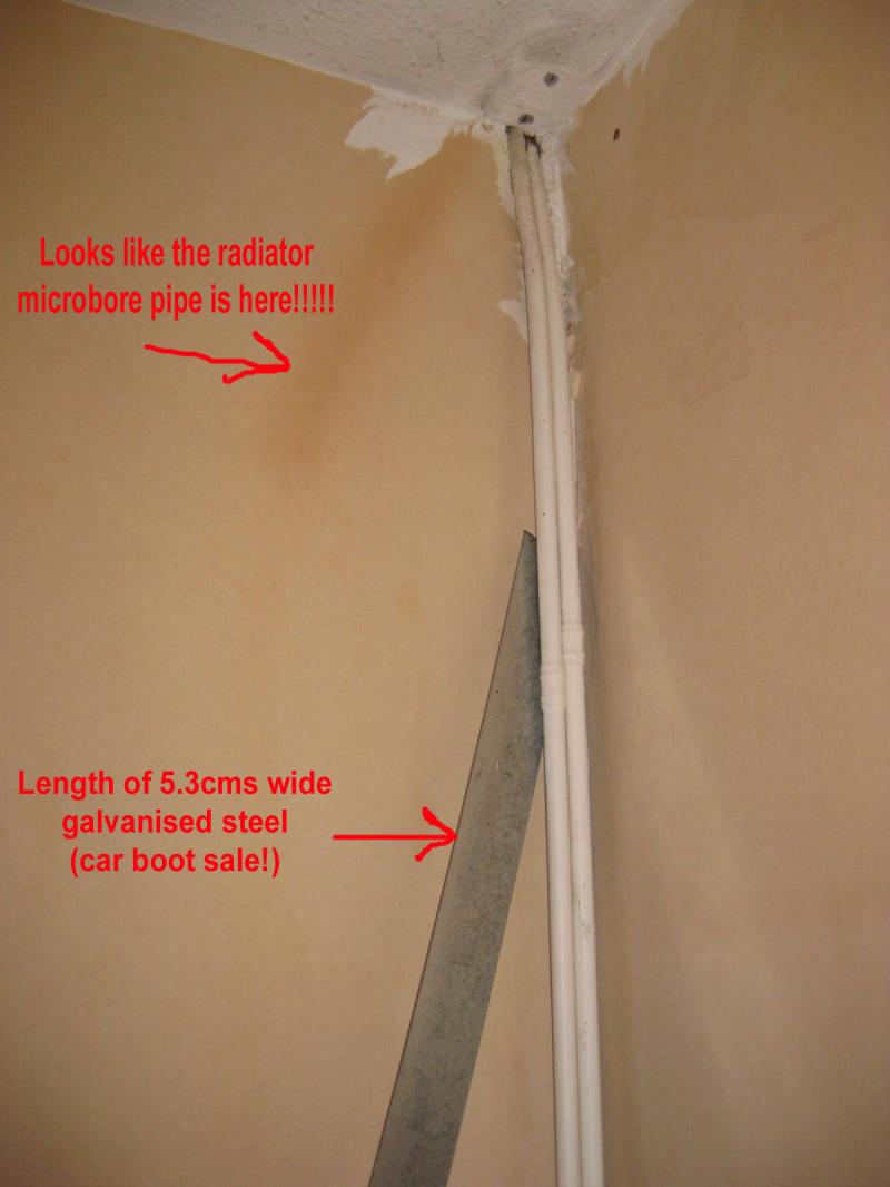

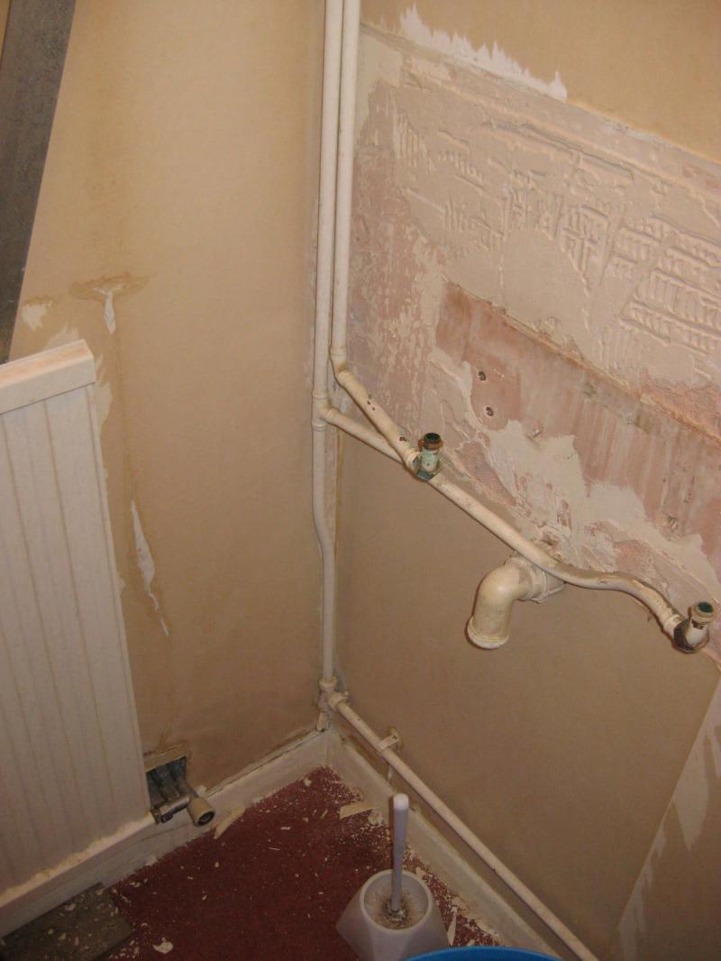

Traced the H&C supply up into the space between ceiling and upstairs bedroom...successfully fitted service valves (with a temp end stop on the downstream end of each to be doubly sure). Very pleased with myself as no leaks. So the downstram pipes are now empty and temporarily disconnected where they now come through the ceiling into the cloakroom.
Now to my question. The pipes were positioned as you can see in the photos, but if possible and sensible I'd like to chase them in so they are buried in the wall. I'm happy doing the chasing as I've done that for electric cables before but wondered what the pros would recommend as far as securing the pipes, padding with felt, and surface finishing etc. I'd just like to bury the ones coming down vertically as I'm happy to have the horizontal lead offs to the basin clipped external to the wall. Also the cold water feed to the loo at 6" from floor can be clipped as well.
I had the thought that basically I could chase out a groove and then reuse the existing pipe and just move it into the groove. I managed to pick up a piece of galvanised steel strip about 5 cms wide I was thinking about using to hold the pipes in, but of course I'd have to insulate that from contact with the copper to prevent galvanic corrosion. Do you use felt or something? The pipes have a couple of sound soldered joins in midway. Obvously the new bowl would be connected with hoses rather than the fixed piping from the 70's!! Also any tips on making good the surface filling? Actually the bottom part up to 1m will be tiled so I don't have to worry too much about surface finish for that part
I'll go pretty cautiously with the chasing because as you can see in the photos there's a buried pair of microbore central heating pipes to contend with.
