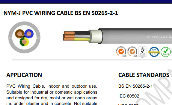

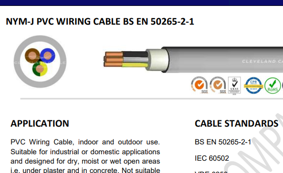

Hi-Tuff is always black sheathed. NYM-J is grey but isn't UV tolerant (nor is it BS compliant but is a VDE product).
Looks OK to me
And still no mention of a minor works cert for addition
