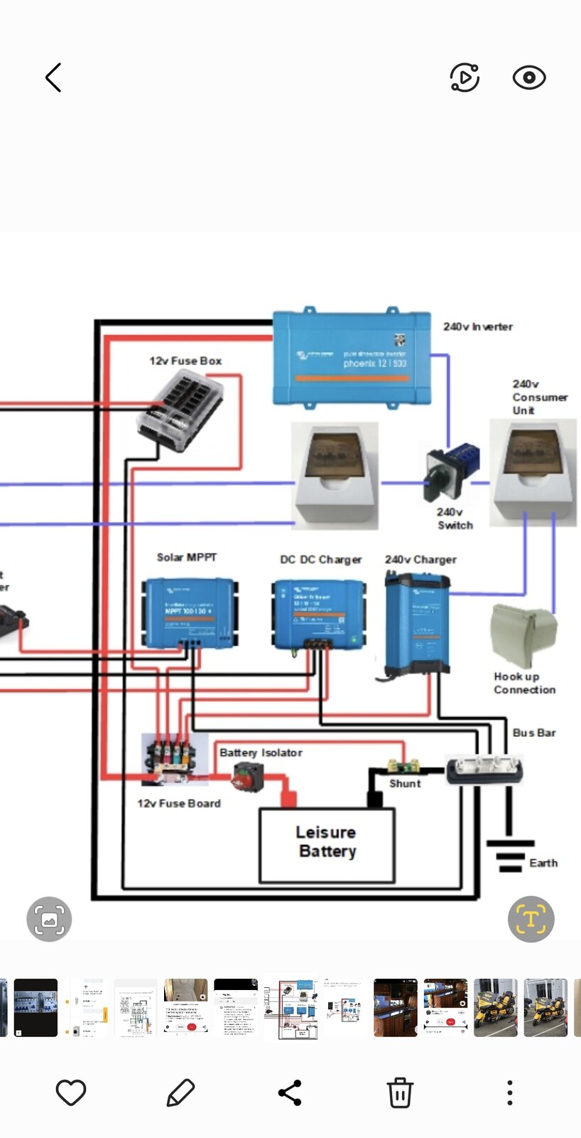

hi all, im working on a horse lorry to camper conversion and i have 3 power sources
1. Solar
2. Electric hookup (shore power)
3. Generator.
Explanation:
I have one consumer unit that is used for the shore power and generator and i have a switch which i can switch between the two, so i can either use the generator (if electric hookup/shore power not available) or if im on a campsite i can flip the switch to shore power. i think you get what im saying.
The second consumer unit is connected from my 3000w inverter, i would also like to add that i also have a switch which i use to switch between the two consumer units depending where i am getting power from.
What I'd like to do:
I'd like to add 1 ring to the two consumer units.
Question:
How can I add 1 ring to 2 consumer units and have the ring supplied with power depending where the power is coming from eg, Inverter, Generator or Shore Power? can I add a 2 way switch and connect the two consumer units to ring via the switch.
Sorry if this sounds complicated.
Thats wrong and cannot be done, should only have 1x cu with the genny plugging into the 16a shore power socket, and 10a radials for the sockets.
The max power is only 16a, less in eu countries so a ring would be pointless
the changeover switch should be wired before the cu with the shore/genny to 1 input and inverter (with a remote on/off) to the other input and the outgoing to the double pole rcd protected cu.
The socket earths should be connected straight through and not be switched by the changeover
The battery black is negative not earth and if you have an isolated dc to dc charger, should not have a connection to the chassis negative

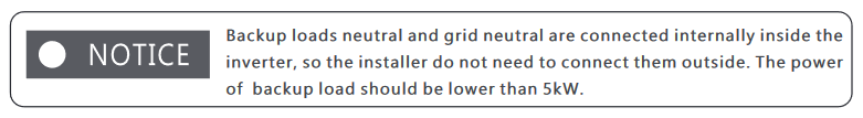

I note with my inverter instructions say
so one has to be very careful, it is clearly not a DIY job, and from the days when I was involved with narrow boats and caravans things have moved on. Even the wagon electrics have moved on, some now use a version of probus for the rear lights etc.
