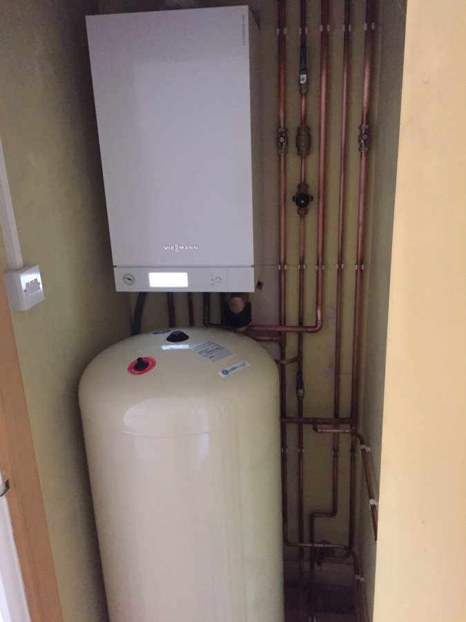

This combi boiler runs 2 showers at once no problem.
Ignore what's on the quote.
Talk to your installer explain what you want.
If you trust him go with his recommendations.
The job of the above picture was for a customer who was told that they could not have a combi by several installers.
Requirement was
2 people 90% of the time but want to be able to run 2 showers/outlets together.
No stored water in the loft
No noisey pumps.
Job done
