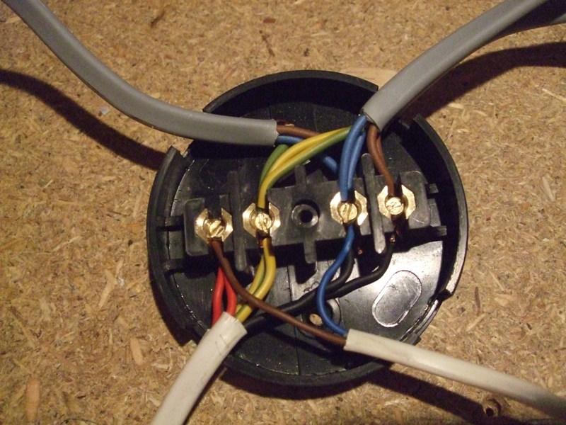

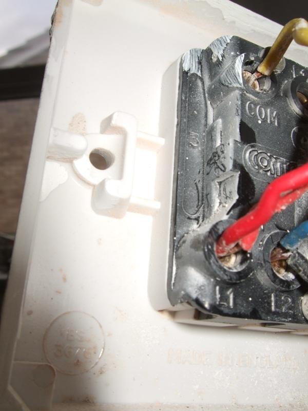

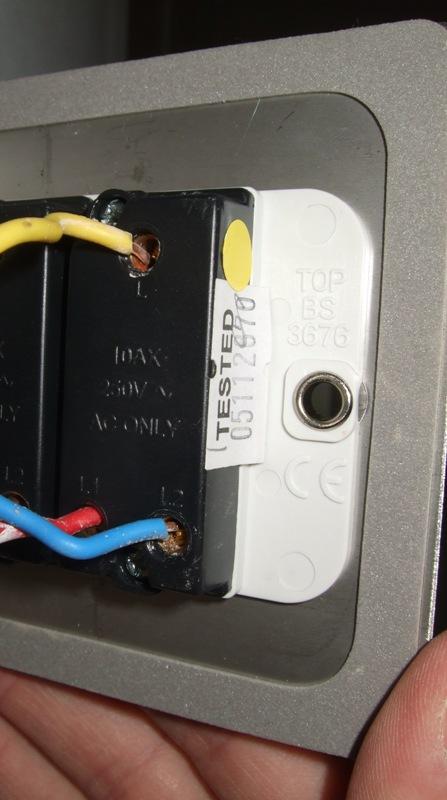

I have added some additional photos of the wiring in the switches, Spotlight, junction box etc.

bottom right hand cable in the JB picture goes where?
sure you got the right black wire as the neutral??
if you have the wrong black wire as the neutral you are getting "feedback" from another light when switched off..
do any of the other lights seem dimmer when the LED's are switched off, or so they work properly when the LED's are switched on?
Also, why does the T+E exiting at bottom right of the JB not seem to have the CPC connected? If it's a switch drop (although from that wiring it appears not to be) then I'm not suprised you're having problems. Even if this turns out to have nothing to do with it, all CPCs should be sheathed and connected to earth.
Bottom right hand cable in the JB picture goes to a loft light with a switch. Agree that bit is not the best installation, should get a proper light and cable while I am at it. I did not have it connected initially so the problem was there before.
On the bottom left hand side there are 2 cables, one goes two the landing switch and the other is the Live and Neutral. I have checked them with the multimeter so I have not mixed them up.
All the grey cables on top are going to the spotlights in a star congiguration rather then serial as it woud just be a waste a cabling.
I have checked all the lights and if they change when switching the LEDs on/off but no changes.

The bottom right cable appears to be 2 core flex.
I'd double check the switch wires are the right ones, and make sure the loft light works with the LED's switched on and off..
