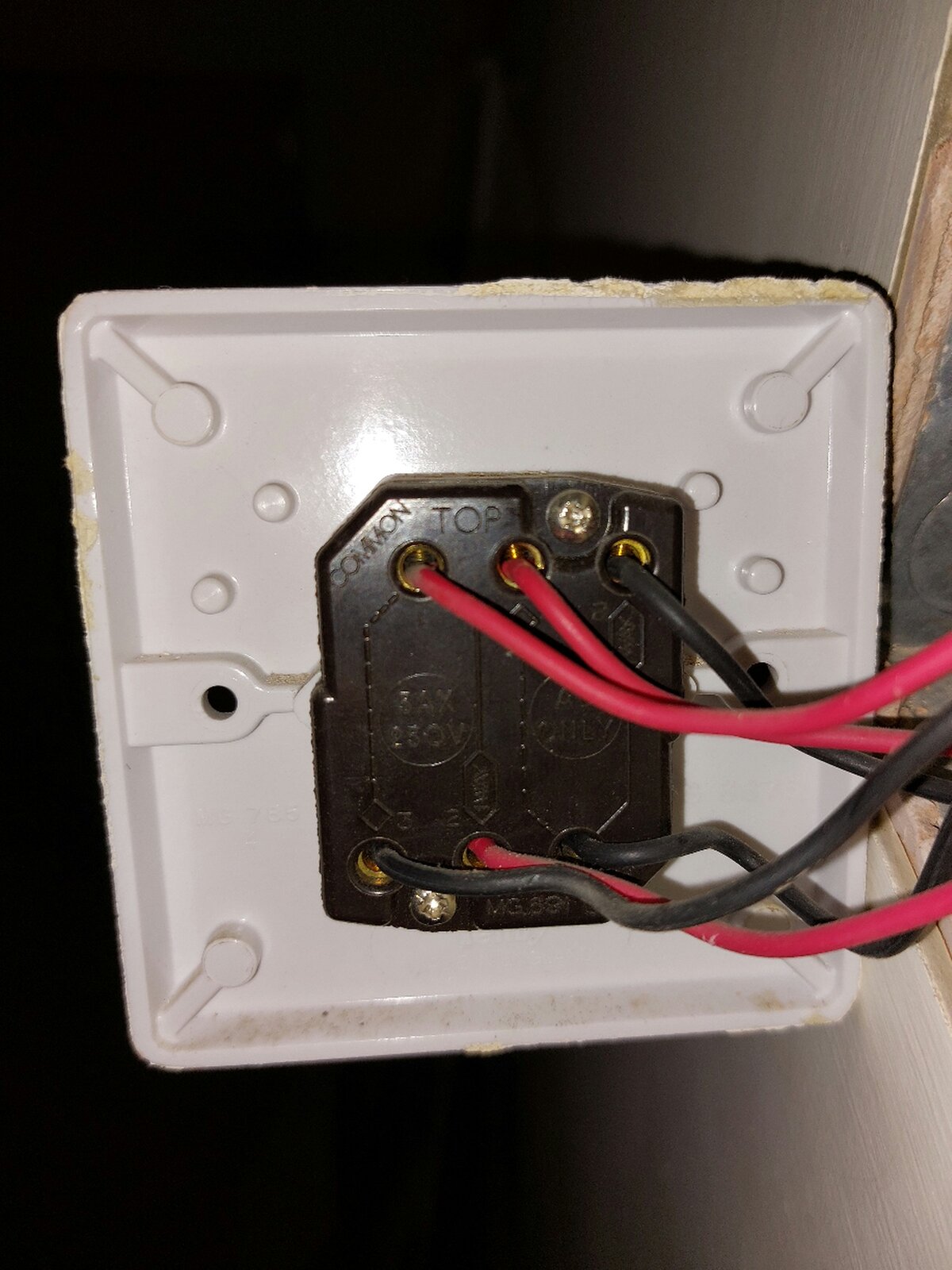

Dear All,
Would appreciate some guidance in replacing my 2 gang 2 way switch in the hallway.
I have read all of the previous posts but could not find the exact guidance.
The old switch has...
Common (2 off)
Terminal 2( 2 off ...also labelled as 1 way)
Terminal 3 (2 off) ... checked by tester ..is live
Right hand switch controls 2 lights in hallway and the left hand switch controls only 1 light.
Photo is attached for reference.
New switch has...(2off)
Common
L1
L2
My question is how do the old wires map across to the new one?
(Is it a diagonally split switch with one straight and other upside down?)
I will ensure earthing is done .
Thank you,
What are you asking?
You realise that the switches are two triangles.
It will be an exact copy.
COM to COM
2 to L1
3 to L2
although L1 and L2 the other way round doesn't matter.
