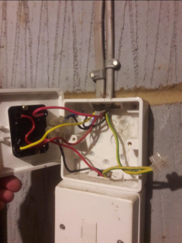

Hi, the above image is the currently connected state of a 2 Gang switch which I believe was part of the old house alarm that has never worked and mostly been taken out. I was assuming that these two switches powered the internal PIRs, outside alarm boxes and an outside PIR.
I was hoping to use one of these switches for an outside light in place of the old outside PIR which I disconnected (live, neutral, earth). I tested power to these wires and found that there was a 240V no matter what the switching arrangement of the 2 gang switch although there is no power when the fuse is pulled, so I'm deducing power is coming from this circuit however I can't understand why the switches make no difference to the voltage test. I used an analog multimeter to test the AC voltage between the live and neutral, should I have tested between the live and earth?
I also can't understand the existing wiring of the 2 gang, I would have assumed that the main feed coming from the fuse box would have been connected to either of the coms. It doesn't seem to match either a one-way or two-way. Obviously a one-way switch would be best.
Any helpful insight would be greatly appreciated.

Your diagram shows the red from the 13A connected directly to the red of the light. It’s not been switched as it’s in the same terminal
OK so basically whoever connected this up just used the 2 gang to make a permanent live connection to both circuits, as it stands the actual switches are irrelevant? is this correct?

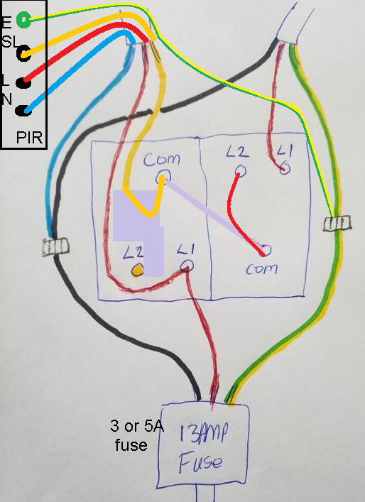

It would make a lot more sense if the incoming red wire from below went to either of the COMs and that the PIR had an override. I really hope the yellow wire is not being used as the earth, so don't move the red wire into a COM until you've sorted out the PIR end and sorted out or disconnected the other cable too.

Does you PIR fitting have an overide facility?
Assuming it does the following is the way to go.
This will give a permanent live for the PIR feed on the red,
Neutrla on blue.
Overide [or may be called switched or switched live] on yellow and
Earth on green/yellow.
Check this circuit is on an RCD.
Don't forget to change the fuse to 3A or 5A

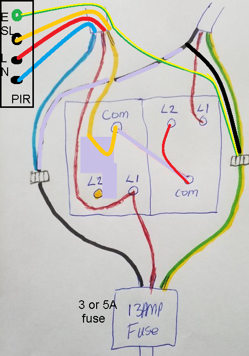

Removing the link between COMs disconnects the other cable. Actually i suggest 'parking it in L2 as shown so it's there for future use.
Additionally I suggest removing the unused black wire from the joint and putting it in with the earths.
