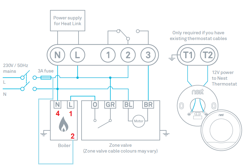

I would like to connect 2 Google Nest Thermostats for 2 zones to an Intergas Rapid 32kw (used as a combi boiler).

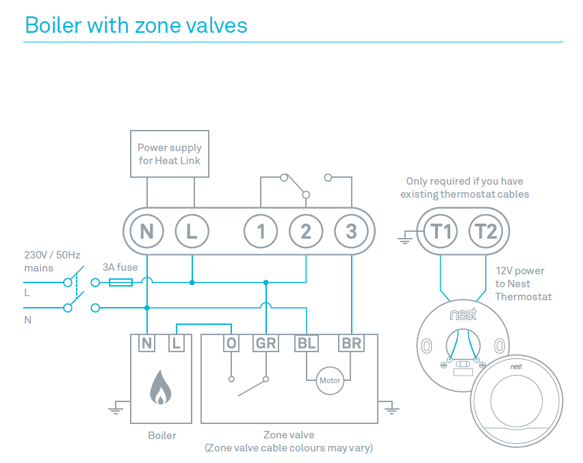

Below is the wiring for the Nest as provided by Google:

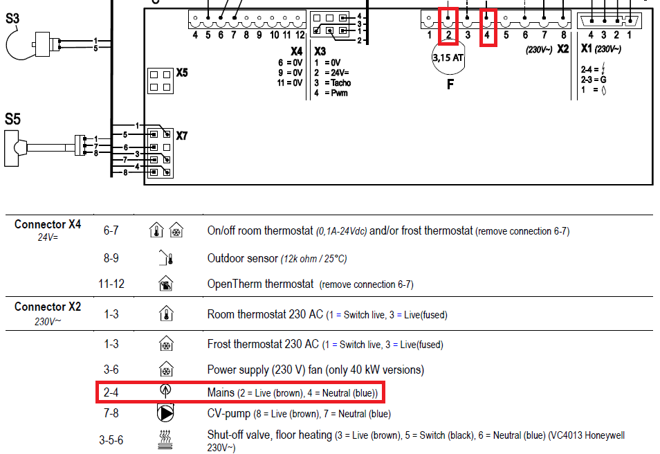

Page 63 of the Intergas Rapid 32kw manual shows that the Live and Neutral are on pins 2 and 4 of the X2 connector (refer to screenshot below).
Is this just a matter of connecting both Nest Heat Links as per above diagram and connect the Live and Neutral to pins 2 and 4 of the X2 connector on the Intergas boiler?

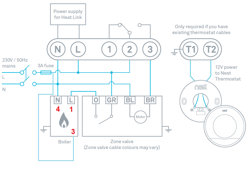

Your Switch Live goes to Terminal 1 on X2
I added the terminal # of the boiler (in red) on the diagram below, is this what you mean?
Brilliant Andrew, thanks a lot!
