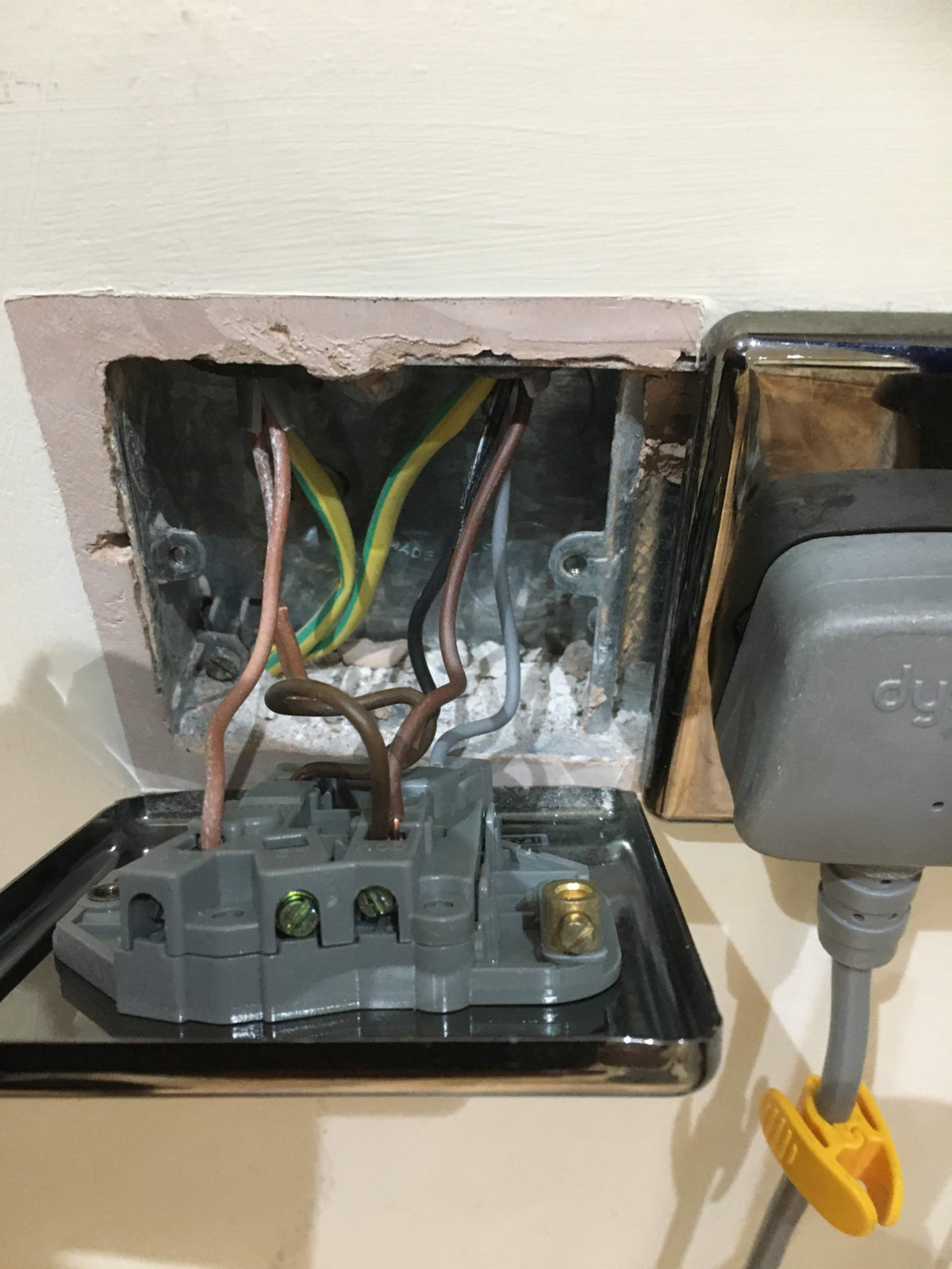

I have a 2 gang light switch, one of the switches is for my main kitchen light and is 2 way and works fine, the other switch works my outside light but it will only operate when the other light is on, is this a simple fix please? Would a picture help?

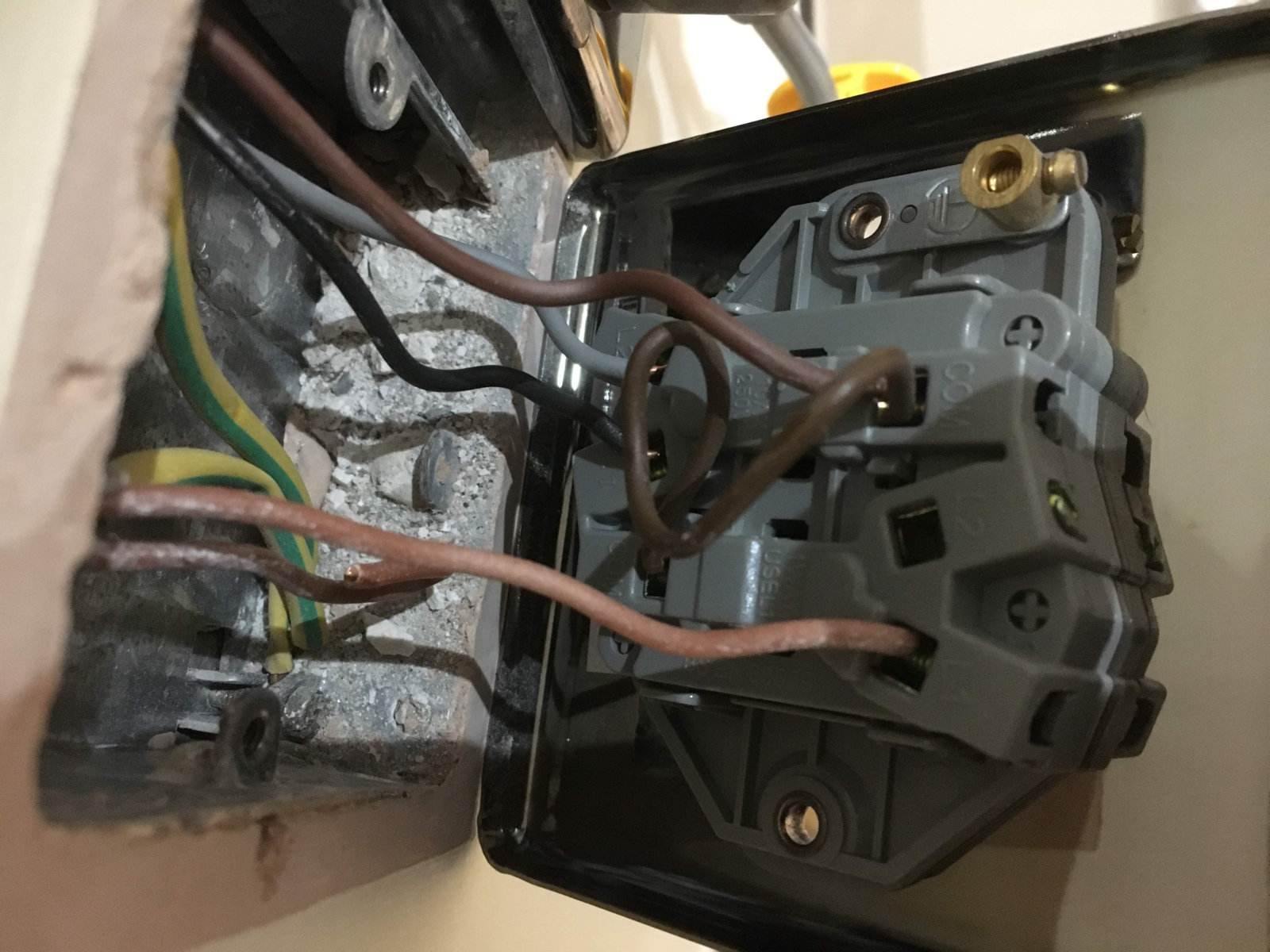

anyway, after taking the switch off I noticed a wire that looks like the copper has snapped.

The brown insulated conductor that is loose may be the permanent live for the outside light switch. Do you know how to SAFELY use the multimeter on a live circuit to test the loose wire by measuring voltage between it and earth ?
Someone has botched that, using the switch wire at the common of the 2-way switch, as the feed to the outside light switch. The later needs a live to be sourced from somewhere.

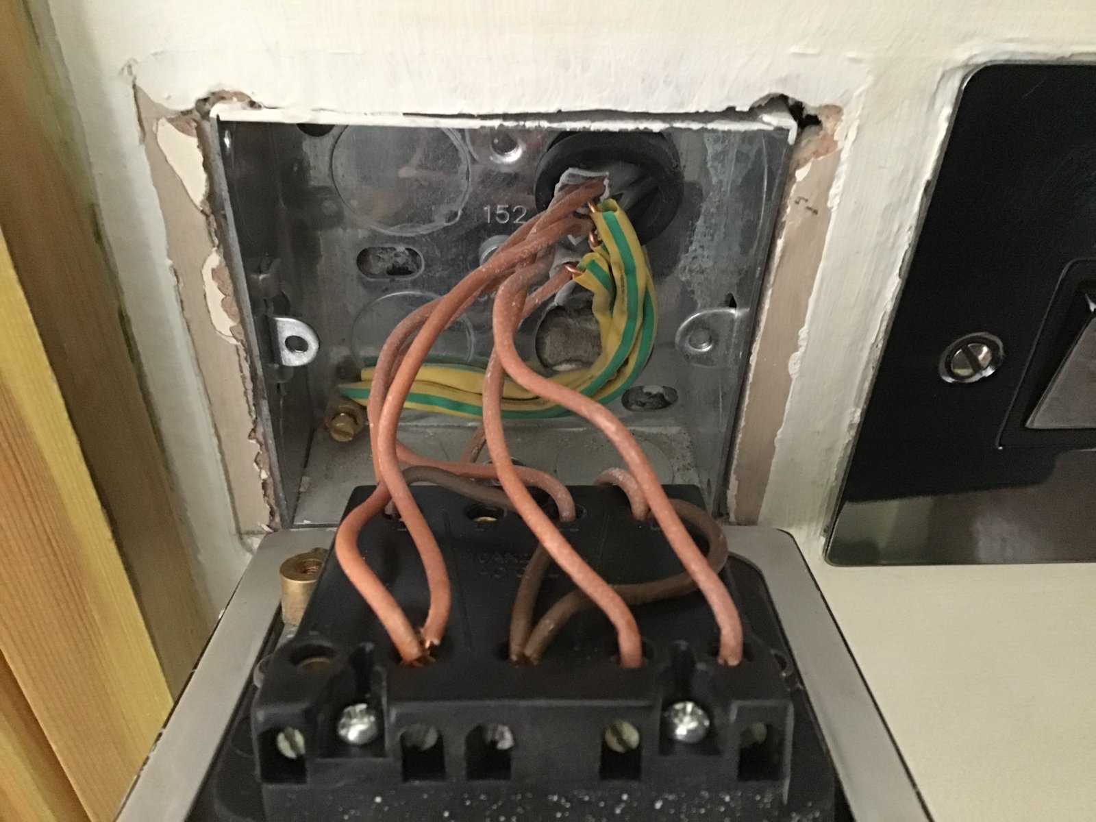

And a pic of the wiring of the other switch.

I doubt that wire is a live, judging from the way it has been just folded over and left. As a minimum I would have expected it to be folded over and over taped.
Hi, sorry it’s been I while. Here is the picture of the other switch
