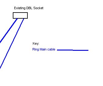

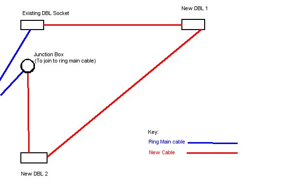

i have drawn a diagram to clear up any confusions.

That looks the same as what I was going to do yes. Just rotated 90 degrees anti clockwise.

Yes your diagram depicts what I am now intending to do.
(Original)
(Proposed ring main extension)
