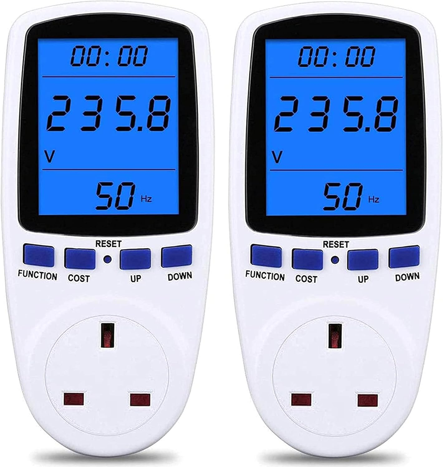

I haven't looked recently, certainly not since before Covid but I have very crude plug in meters which display highest and lowest current and voltage, peak total and average power over the measurement period. This sort of thing
Bearing in mind this is a 13A unit to plug a device into, and I added a 10:1 current clamp which may or maynot be calibrated accurately but does give a believable result (let's be generous and say within 10%) I measured the 6 week lights period one winter our peak power was close to 25KW (I suspect we are on a 60A fuse as we're a looped supply) but I had no idea how many times or what duration, our average was below 1KW.
Another way of looking at that is we were peaking at 80% of the total supply for 5 properties.
