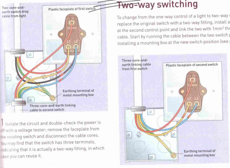

I have purchased a Get plc dimmer switch from B&Q to install in my living room, where I currently have 2 switches wired as per the following diagram:

What colours cables have you got in the switch you are replacing with the dimmer and how many. Is any of them a 3 core cable. Please make a note of which wire goes to where before taking anything apart and ensure no power is connected. Can't see what the problem with the instructions is until you give us more info.

There is a 3 core and 2 core cable, wired identically to the first diagram.
The difficulty that I have is that I currently have 5 wires (excluding earth):
Red going to "COM"
Red and yellow going to "L1"
Blue and black going to "L2"
The instructions only provide for 4 cables within the dimmer: 2 red and 2 black or blue. I am uncertain which way around the blue / black wires should be and what happens to yellow.
Thanks for your time.
Just follow the instructions....
From the looks of the dimmer instructions, all the switching is done by the dimmer unit, and the second (third and subsequent) switches just provide a 'pulse' to switch the dimmer on or off.
This is a completely different method of running 2-way switching to the setup you have at the moment, so it's not surprising that the two wiring diagrams don't correspond.
Red going to "COM"
Why is that a difficulty?
What does 3+2=? :rolleyes:
They show which terminal is connected to which - what more do you need? :rolleyes:
FFS - have you actually read Important Note 6? :rolleyes:
