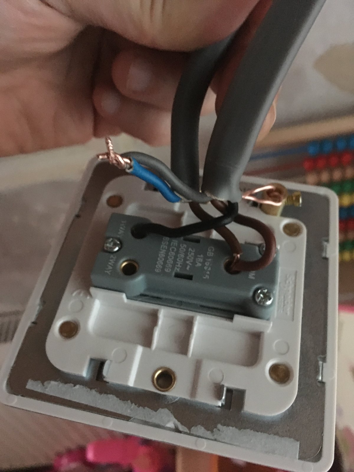

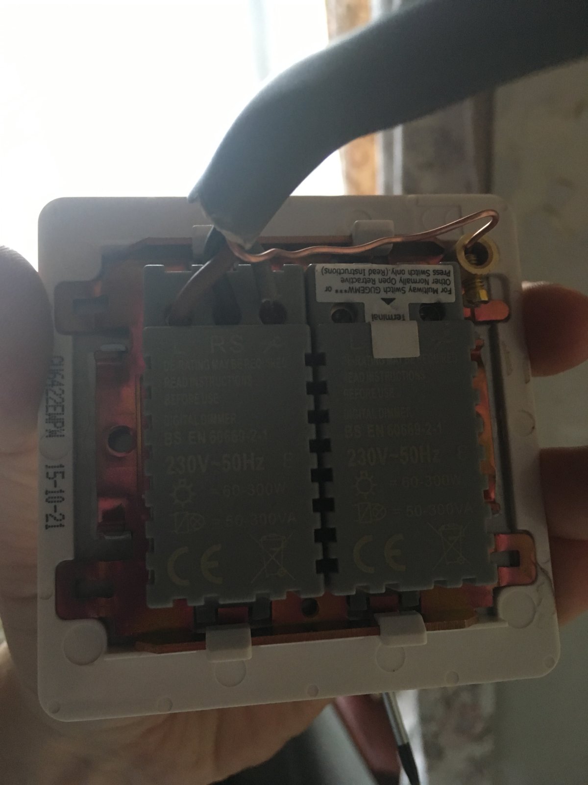

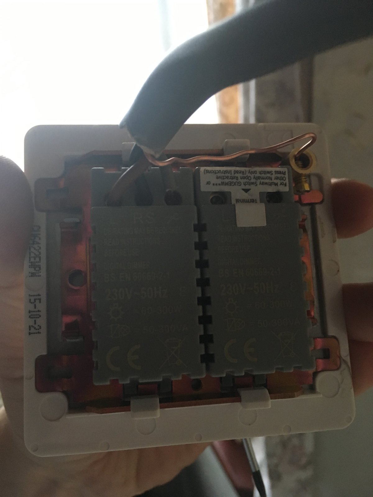

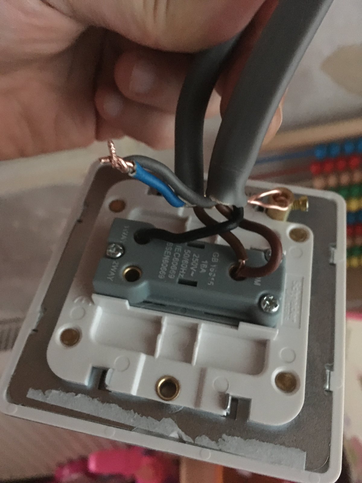

Dimmer: brown in live, grey in RS, black in neutral.
Retractive switch: brown in COM, black in 1-way, grey in 2-way.... i then have brown in COM and blue in 1-way going off to the pendant.

its wired wrong, looking at the instructions it says do not use l2 on retractive switch! hope its not fried it
you need brown t&e and brown 3core into the common of retractive switch and into L at dimmer end
black 3core into 1way at retractive and into rs at dimmer
grey of three core into squiggle on dimmer and into connector block at retractive switch along with the t&e blue
ensure the blue,black and grey have brown sleeving to indicate switch lives
Thanks... just tried that but the retractive switch doesn't do anything. The dimmer is working fine but nothing from the RS end.
This is how i wired it...
have you a multimeter to test between common and L1 for continuity when switch is pressed, this is done with power off

That blue is NOT a neutral, it is a switched live and should be sleeved brown.
Likewise the black on the dimmer is NOT a neutral.
To be honest, there possibly the poorest installed switches , I have ever seen.
The cables need to be prepared and sleeved properly and using the supplied instructions, work out what you need and adapt the existing wires to suit.
If it was 2 normal 2 way switches before, then a Dimmer and Retractive switch will likely involve less wires to be used.
