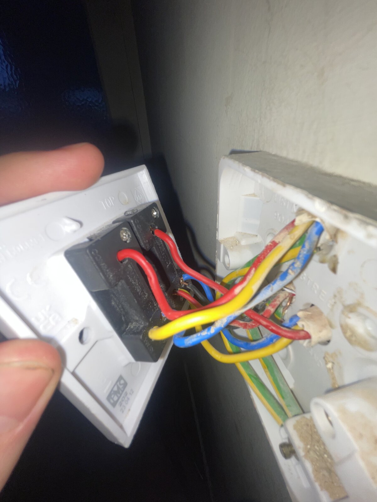

Hi!
We’ve recently bought a property and have 2 2 way gang switches for our hallway and landing lights.
Our landing light we can switch on upstairs, but not downstairs, and the hallway light does not switch on with either. Pre-2004 wiring, 110 year old house. Lights work everywhere else.
Have attached a picture of the wiring of the downstairs switch - we have now swapped the red/black in the L1/2. Upstairs matches exactly the same. Any ideas?
For a start -
Make sure that you have the red wire of the red,blue,yellow cable in the 'other' switch COMMON.
If not, post picture of other switch wiring.
