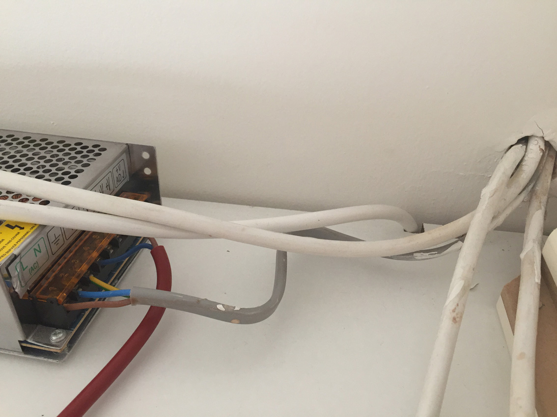

After teaching myself the necessary skills I put in a new kitchen just over a year ago and installed new wiring throughout. It was all inspected and the electrics were signed off by a qualified electrician. The only thing I didn't finish wiring up was the LED mood lighting. The main wiring was completed all the way to the power transformer that sits above one of the kitchen units (so as good as finished), but the LED strip lights themselves weren''t installed and wired up to the transformer - a job I thought I'd complete after a couple weeks break.

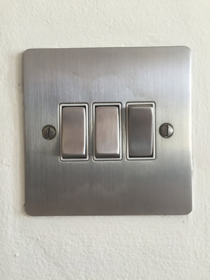

My kitchen's primary light socket is a 2-way 3 gang light switch. Only the first gang/switch operates on a 2-way circuit though (the main kitchen ceiling light can be turned on at the primary switch and at the other end of the kitchen on a secondary 2-way switch). The second gang/switch operates as a 1-way switch to operate a pendant light, and the third gang/switch operates as a 1-way switch to operate the LED mood lighting (specifically to provide power to the aforementioned power transformer).
All the switches work, but the third switch for the LED mood lighting is back to front. To keep things simple all the lights are supposed to be OFF when the switches are in at the top and out at the bottom. But the LED mood lighting switch is ON when it's in that position.

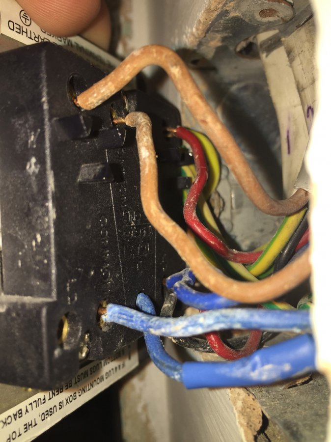

The brown wire was in 'COMMON' and the blue wire was in 'L1'. I thought that the brown and blue wires must simply be round the wrong way, so I swapped them round, but nothing changed?! The switch still operates the exact same way and the LED lighting is ON when the switch is in the OFF position.
I've included a few photos of the 2-way 3 gang light switch in question, and the LED mood lighting power transformer, just to better explain the wiring.
The brown and blue wires are the 2 nearest the camera which serve gang/switch number 3.
Is there a simple way to get the switch to operate like it's 2 sister switches and be OFF when the switch is IN at the top and OUT at the bottom? At the moment the lights are all OFF when the switches are positioned as in the photo below.

Yes.
Put the blue wire in L2.

Anyway, thanks endecotp, I had already attempted that but it doesn't work. It doesn't turn on at all when the blue wire is placed in L2.
That power supply is designed to be installed in an enclosure, having the mains wiring exposed like that is not good. There should be grommets fitted to the cable entry holes on the switch box. The switch wires should be correctly identified as line conductors with coloured sleeving etc.

I assume you have put the brown wire back in the COM terminal:cool:

Like has already been said, brown in the common and blue (which will obviously have brown sleeving on as you've learnt the necessary skills) into L2 if that doesn't work then the switch is faulty
Thanks for that. It's not 'designed' to be enclosed, but it certainly can be under some circumstances and requirements. As far as I have been led to understand there is no legal requirement for it to be enclosed in my situation (away from water and up out of reach of people and animals). If I am wrong I'd be very pleased to see evidence to the contrary.

I assume that you have a multimeter; try measuring conductivity through the switch to see if it is faulty.

Thank you (y), yes I've just done that. With the switch one way (so 2 terminals bridged) there was perfect continuity, but with the switch the other way there was an intermittent break in the circuit. I opened the switch and one of the metal rockers (for want of the correct name) was fractured and didn't create a stable connection. Very luckily I had a spare matching 2-way 3 gang switch in my electrical cabinet (I fortunately bought more than needed when doing the kitchen and other rooms) which I've just installed and it's now working correctly. :)

What did he say about the lack of grommets?
