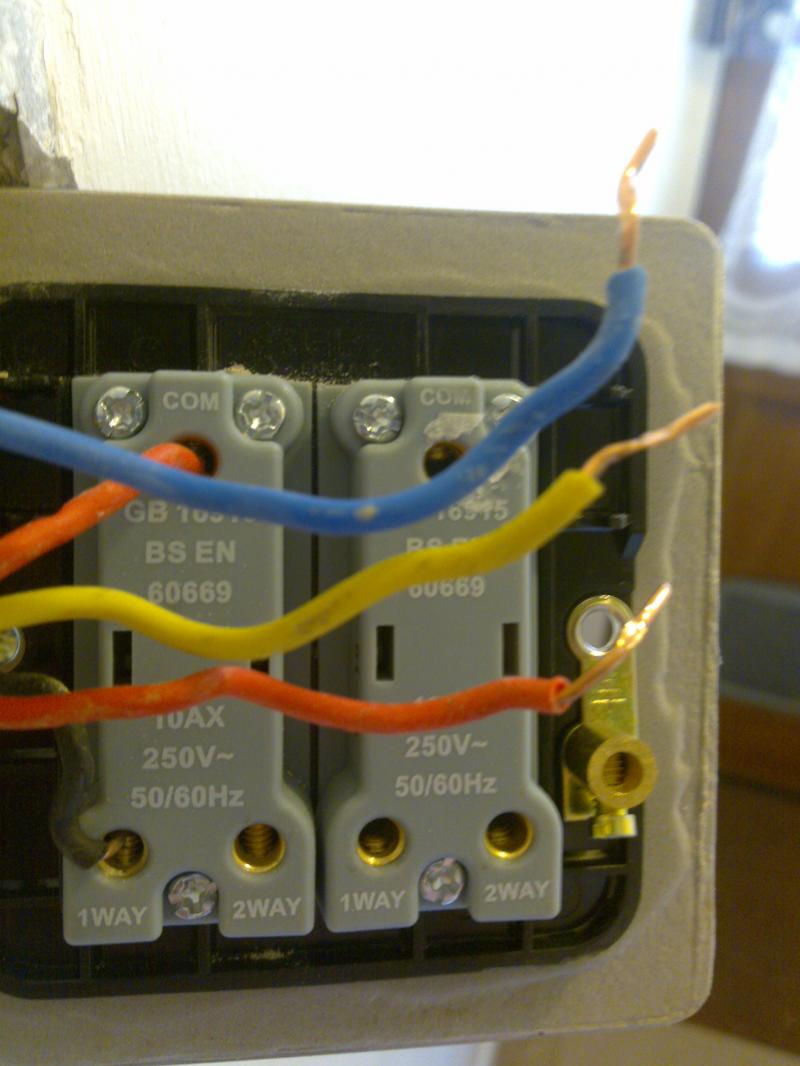

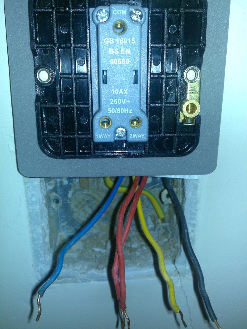

Hi, I am trying to resolve my brothers 2 way light switch issue, but this one's got me stumped. I have a basic knowledge of how it works (I have had a similar issue at home) but I just can't figure this one out.
He has a light at the top of his stairs with the usual switch at the bottom and another one at the top. The one at the bottom is a 2 gang switch which operates the light at the top and also a hall light at the base of the stairs. The switch at the top is a single gang version.
The wires at the switch at the bottom of the stairs are YELLOW, RED and BLUE. The wires at the top are also YELLOW, RED and BLUE but with additional RED and BLACK wires.
I have tried a tester in various configurations but I haven't had any luck making and sense of it.
Any help would be greatly appreciated... Thanks :eek:)
P.S. I have included some pictures if they help
spot the mistake ... no flying earth on the face plate ! make sure font plate is earthed up and sleeved accordingly and earthed to the metal back box
The faceplate earth connection 'lug/connection' is part of the faceplate screw hole/housing, so the screw would act as the connection between faceplate and backbox.

So use the earth terminal on the switch plate.
