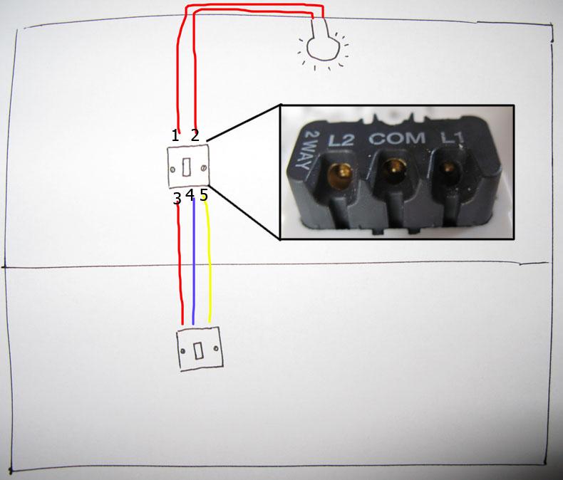

We have a landing light, controlled by two switches. One downstairs, one upstairs.
I've replaced the upstairs switch, and I've been unable to rewire it successfully! (yes, I do regret no noting which wire was wired to which terminal :D )
I have 3 wires coming from downstairs (red, blue + yellow), an 2 wires from the light (red + red). This is a mid 80's house.
Could anyone advise which wire I need to connect to which terminal on the switch?

The two reds you have coming from your fitting in the diagram, one red will be permanent live and supplying the live to switch via the loop and the second will be returning the live to the lamp(bulb?) this will be connected to the live terminal on the fitting.

put the red/yellow/blue in exactly the same holes as the downstairs switch ( we can't tell you which ones as they may not use a standard layout.. )
then put the one red in L1 and the other red in L2.. ( from the red/red cable.. ) and the earths to the backbox if metal ( and to the switch if they are metal too.. ), or into a connector block if it's plastic ( still to switch if metal ) ..

ColJack - you were spot on with your suggestion of matching whats downstairs to what I did upstairs.
The downstairs must have been wired using wrong colours or something, but I matched it upstairs and now it's all working :)
Thanks again.
The downstairs switch was:
L Red
L1 Yellow
L2 Blue
I think I'll redo the lot tomorrow so they're where they're supposed to be.
