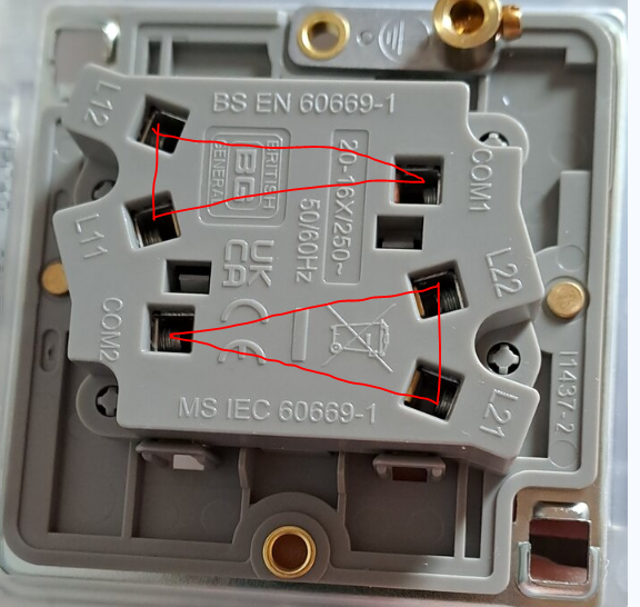

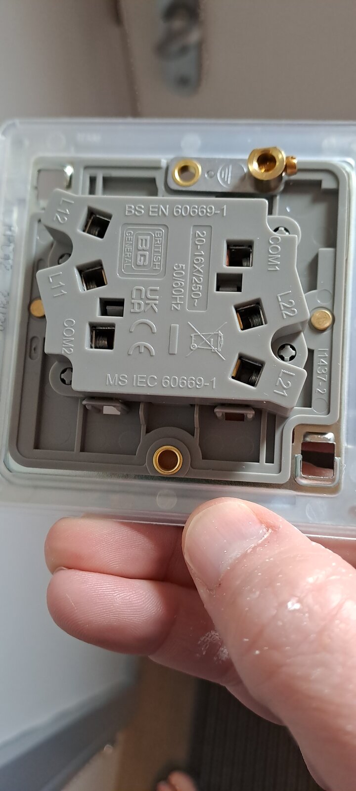

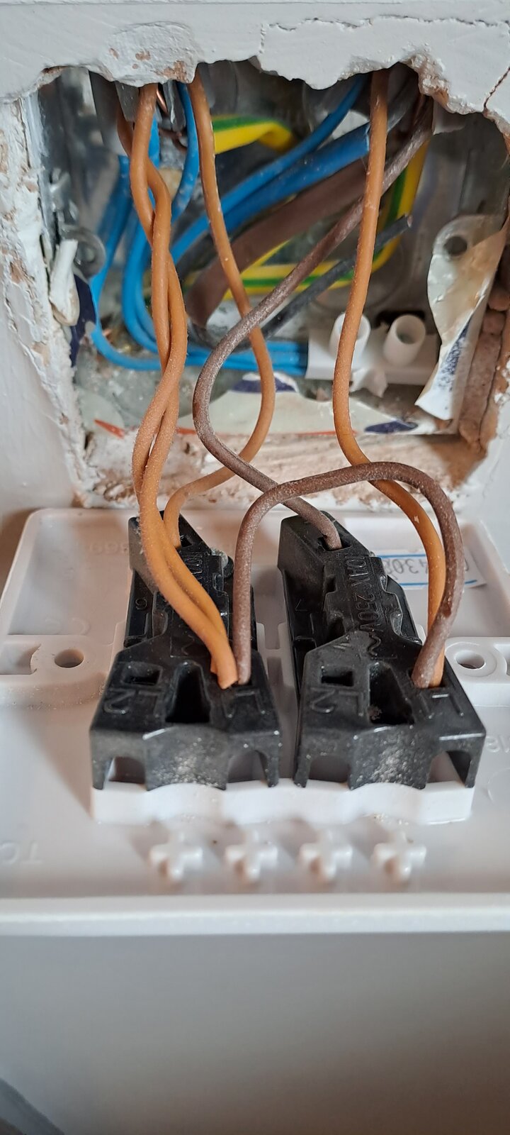

Hello,
I would like to replace my light switches in my house (built 2019) but last time I did l this in my old house things looked simpler. Please see the attached photos of the old switch and the new switch. I'm confused where to put the wires in the new switch. This switch in particular controls a light outside and the halway light.
Any help is much appreciated.
Your old switch is two triangles the same way up; the new switch is two triangles with one upside down.
Just mark the wires before disconnecting so you don't mix them up and then copy exactly.
COM and L1 of one switch (right), go to COM1 and L11.
COM and L1 of second switch (left), go to COM2 and L21.
You must also ensure you attach an earth wire to the earth terminal of the new switch, to the green/yellow earth, I see tucked away at the back there.
[EDITED TO CORRECT]

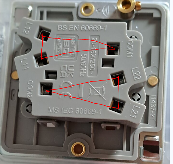

COM and L1 of second switch (left), go to COM2 and L12.
Thank you very much for the speedy response. I'll be sure to attach the earth as this switch has a metal faceplate.
Sorry to bother you Harry. Did you mean L21 on the second (left switch)
Yep, sorry and well spotted. COM1, L11, and L12 form one switch, COM2, L21 and L22 form the other, three terminals to each switch.
I'm annoyed with myslf, I read you initial response and accepted it as correct as some makes have used COM1, L11, L21 for one switch, COM2, L12, L22 for the other. So I didn't bother to double check you.
