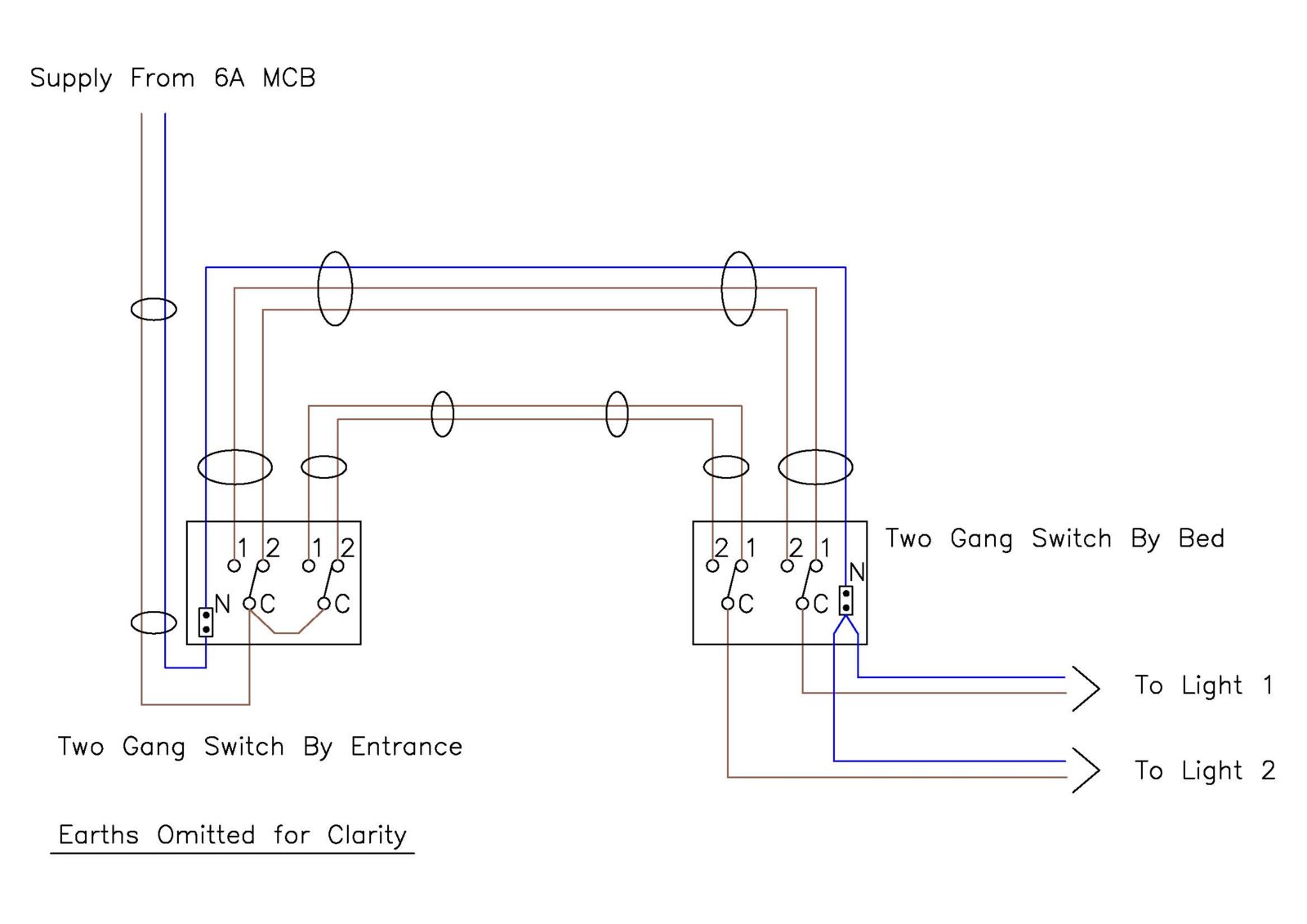

Hello All...
A little help appreciated for an upcoming job...
New fitted wardrobes to be installed.
There is strip lights above the wardrobe, which the fitters say they just plug them in, there is also some sort of other light that also gets plugged in.
So I am faced with 2 different lights, both plugged in at ground level.
The customer wants to power these on and off from a light switch next to the bed,
the wiring for this is fairly straight forward, the head scratching part is,
They also want 2 way switching for this on 2 different switches, by the room entrance, so to be clear, 2 switches bedroom door, 2 switches by bed, to turn off 2 different lights plugged in under bed....
Can anybody simplify this for me please? Thanks in advance
Hi General, and welcome to the forum.
I would connect them as per the diagram below. [The colours I used relate to the function of the wires, rather than the wire colours available.]

It's not usual for light fittings that are hardwired in to the lighting circuit with wall mounted switches to be then connected by a plug and socket, however, if the clients insist on it, this type of socket should be used. It is especially designed for lighting circuits to prevent non lighting appliances being connected to the lighting circuit.
