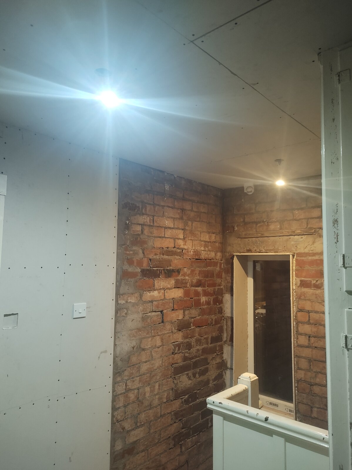

I'm a big fan of PIR light switches, I have 3 in my house and don't need to wave my hands around - they just work when they need to.
I want to fit one to the upstairs landing (I can't find the light switch when I come out of the bedroom), but downstairs (open plan) I'll need a manual switch. Is this possible? The switches I have are ceiling mounted. Doing my head in trying to figure it out, I think the on would be ok but it won't switch off if the downstairs switch is on?

I can design out the safety issues - the PIR would cover most of the route and I tend to have them on a long timer - unfortunately my kids/wife (unlike T of TC's - I'd just get the more direct shove in the back) would never switch off a light so I'll still save loads. And there's 4 rooms opening to the landing.
Just want to know if it's possible at this stage. I suppose alternatives are a conventional two way and second PIR light (or even a basic plug in or battery PIR nightlight). But as I said, PIR is good because the family absolutely love giving our money to the shareholders at outfox the market.
2x PIRs, one at the top, the other at the bottom of the stairs.
Lights switch on when one or both PIRs are triggered.
A PIR and standard switch cannot work as required, as the PIR is by design only on for a short time, but a switch could be on or off for hours at a time.
Best case with PIR and a switch is that the switch would work as light on or light is PIR controlled, but that doesn't solve anything as it could still be left on permanently.
Another option would be a PIR, momentary switch and a separate staircase timer relay, where the PIR or the switch trigger the relay to activate the light, but that is swerving into the realms of unnecessary cost and complexity.

I'm going to do - landing upstairs on a PIR, stairs on a standard two way switch (or possibly timer with a long "on time") and ground floor "landing" area on another PIR - both are large enough to merit two lights.

Just an update, haven't done the ground floor one yet so, so far I have the stairs conventional two way set, up and the FF landing on a PIR - it's perfect! It switches on the light literally as the bedroom doors open, when coming up the stairs it (completely reliably) switches on when you reach the top step!
Ignore the bulbs they're just what I had to hand, the one lit up is the PIR, the other is switched and the PIR switch is at the back between the two.
