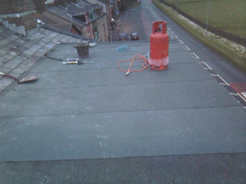

View media item 17467View media item 17465
As you can see i've decided to board it out as the pitch is too low for rosemary tiles. I 'm going to double felt the board, counter batten, underlay felt and cross batten before tiling. I've bought a plastic eaves tray-Do i put this over the felted board (bitumen felt) but under the underlay felt. Do i even need underlay felt(non breathable)? Also, the fascia will probably be plastic, where will this sit in relation to the bitumen type felt -felt up and over or stuck flush to boards end?
that pitch definatly looks more than 22 degree to me i would use the rosmary tiles you have already bought and just give the tiles 4 inch cover that would mean putting the tile battens on at around 3 and a half inch guage but it will look and last alot longer than a felt roof if you do felt the roof with bitumen felt you wont needth felt support trays as the felt drips will go into the gutter

here's the difference between old and new. After the counterbattens go on i think the top 4 cross battens may line up but bottom 3 on the old will be too low. Was thinking about bowing these down gradually further along towards nxt doors to match up or slightly raising up the bottoms of 1st few old rafters,steadily decreasing. Is it necessary to also use underlay felt over the counterbattens as extra protection or is the adhesive type sufficient enough.
