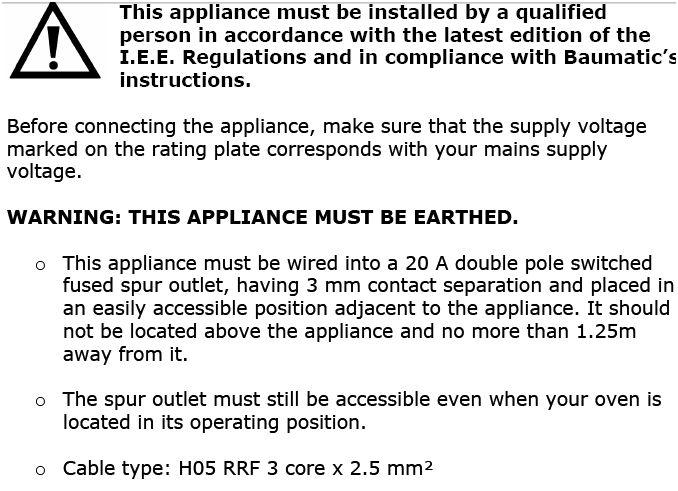

All, getting a new kitchen installed at the moment and i have a question. The instalation guide for the cooker i have says it shoudl be wired to a "20A double poled fused spur outlet"
However, at present the oven is just connected to what was a everyday plug socket,
The cooker has two ovens, when one is used all is fine but when *both* ovens are turned on the main fuse box trips the fuse that controls all my plug sockets.
...is a pretty good clue. The oven must be installed on its own dedicated 20A radial circuit by an electrician.

its a baumatic BT2710ss 90cm twin cavity
Rated Voltage 230 Vac 50Hz
Supply Connection 20A double pole switched fused outlet with 3mm contact gap
Max Rated output 4.34Kw

I'll say again. This load is far too large for a 13A socket, and as it stands, you are in a potentially very dangerous situation with real risk of overheating and possibly fire as a result. Whether you like it or not, and despite the inconvenience, you should discontinue use immediately until you can get a proper supply installed.

The clue is in this bit:
But you are right about what the instructions say:
Per the post above, there is no such thing (certainly in the UK) as a 20A Fused Spur.
You will need two things:
1. A dedicated circuit from your consumer unit fused at 20amps. This will need to be RCD protected to comply with BS7671 (2008)
2. The installation by a qualified person as directed by the instructions!
It sounds to me that the kitchen fitters do not come within that scope. Do make sure that all electrical work done is certified and also is notified to the local authority and that you get written confirmation that this has been done.
