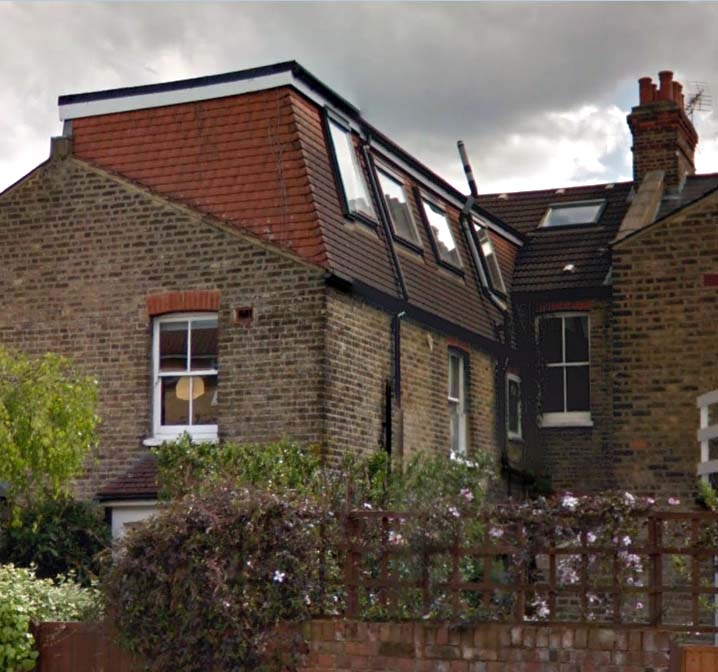

Is this work being done under permitted development as it only applies to PD. There are easements allowed if it isn't feasible to maintain the 200mm of roof. Sometimes BC will pull you up on it but it's not really their remit but that of the planning department.
But as Woody says it only applies to the eaves and not the verges.
Also, some local authorities seem less fussed than others... as this image will attest...

If you are doing hip to gable plus big dormer you may well be over your PD limit! Best check it out as full planning may be required
