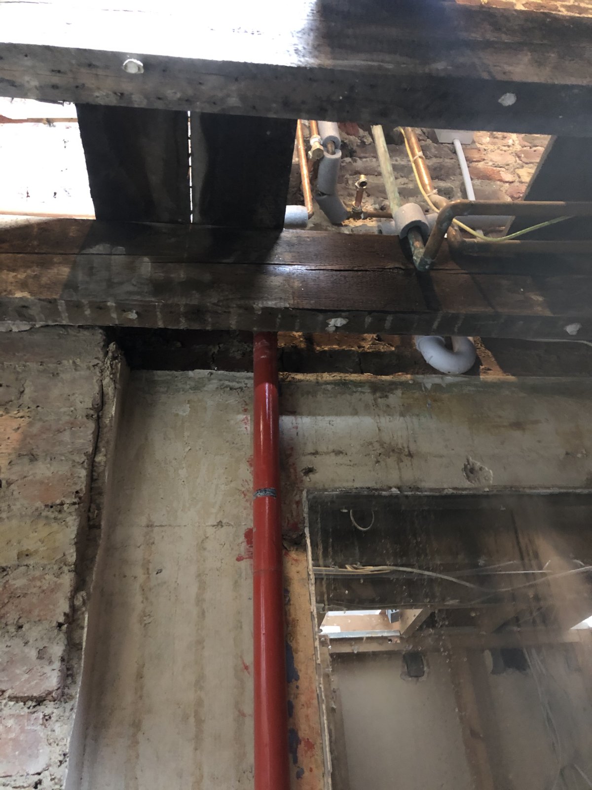

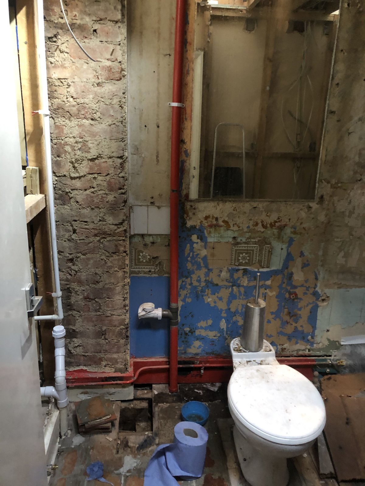

Let’s say I will be installing a thermostatic rain shower where the red pipe is. Would it make any positive difference to the pressure or flow if I ran a 22mm pipe from my combi boiler above down to the level of the shower? The pipe will then tee off to toilet/sink/kitchen.
Bigger is always better for flow, isn’t it?
Not necessarily. The waterways in a combi will be max 15mm anyway, probably smaller, so 22mm pipe is rather pointless as the boiler itself is providing the greatest flow restriction
Ah, right. I was thinking of my old gravity fed shower.
There would be no advantage to using 22 mm pipe. There would be a disadvantage as it would hold more cold water to be flushed out before the hot arrives.
