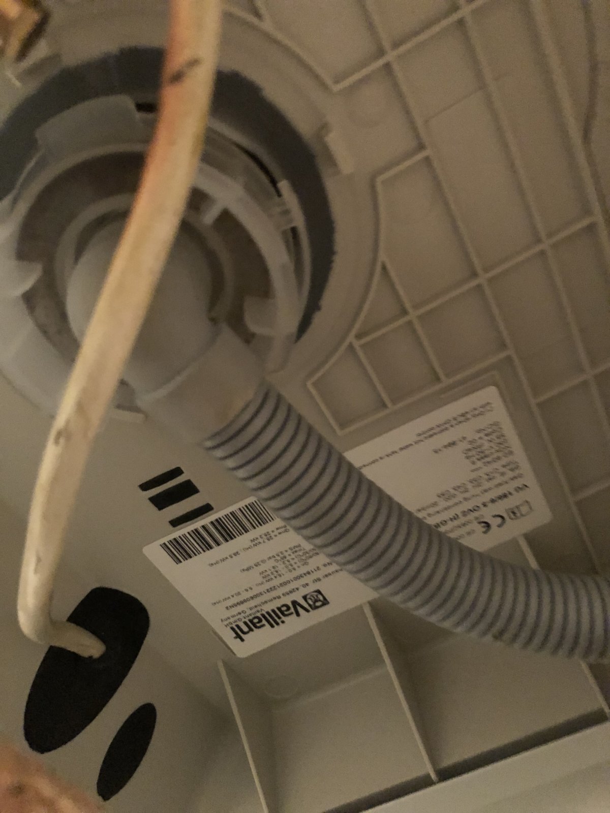

Post a photo of the cable/flex entering underside of boiler.

I detect a reluctance from the OP to post a photo of the wiring centre terminals, this was asked previously but maybe the OP missed it?
You would of thought the OP would jump at the chance and post the photo in order to resolve “her” issue.
