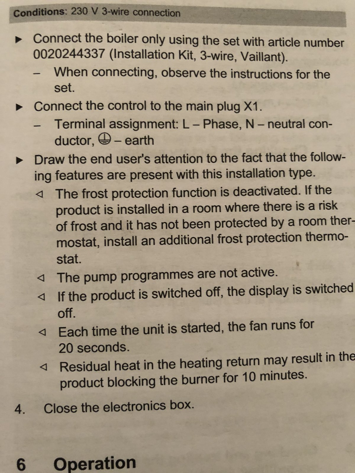

it has been installed as a 230v 3 wire installation, without pump overun. The old boiler was merely taken off the wall and the new one put up - using the same existing cable

Hi. I’ll post a pic from the Vaillant installation booklet (the Vaillant engineer pointed this out to me and confirmed this is how the boiler has been installed.

Vaillant have been out and checked the boiler. - they have confirmed that all is fine with the boiler and the wiring. it has been installed as a 230v 3 wire installation, without pump overun.
Does a three wire installation mean that all power is removed from the boiler when the SL goes low? ie the wires are Earth, Neutral, and a switched live? If so, are you saying that the boiler manufacturer has approved this method?
Once this saga is over, I will have the pump run permanent live connection installed - but just darent at this stage with the major issue we are already having.
So there is a pump overrun feed from the boiler, and it's not being used? And the boiler manufacturer is happy with this?
