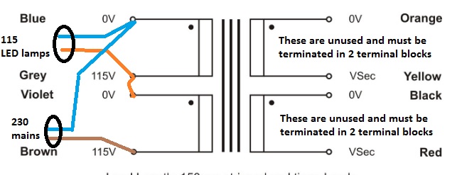

long story short we do a halloween event in our village for the kids in which we open the garden with lights &props and such things while most things are battery operated or std 240v we import a few items from the USA
i need to run a couple of 3w led lamps that have a US plug soldered and the manual clearly states max 125v rather than buying a converter for each lamp does a multi socket exist that will take one uk 240v and give me a couple of 110 outlets that does not cost the earth
or the fact the draw is so small could i splice the two looms together and run of a std 40w uk to usa adaptor

The LED lamps will have some sort of switch mode power current controller to provide a controlled current through the LED element(s). This will have been designed for a 120 volt 60 Hz sine wave AC supply. While they may work on the 120 volt AC from a switch mode voltage convertor this cannot be garanteed as the output from cheap convertors is seldom a true sine wave but instead at best is a stepped sine wave form and at worsr a simple square wave.
A true transformer is your best ( most reliable ) option. Either a small 230 to 115 volt transformer or ( as it is a very low load ) a transformer like
http://www.rapidonline.com/Electric...Toroidal-Transformer-50VA-0-12V-0-12V-88-3795
wired as an auto-transformer.
This is NOT an approved use of a transformer but does provide a low cost way to achieve a 115 volt supply from a 230 volt supply.
The VA rating of the transfromer should be at least 4 times the VA ( wattage ) of the load on the 115 volt.
The four secondary wire must not be connected to anything nor to each other.

With standard tungsten bulbs yes could wire is series but LED lamps need a current regulated supply if that was done with a simple resistor yes it would still work but if there is some switch mode regulator then then likely it will not work.
Years ago I retrieved the step up auto transformers from 110 volt fluorescent lamps but today they are also switch mode. As
bernardgreen says any transformer designed for either 120 or 240 volt could be used as an auto transformer, but although I would not be worried transforming up I would about transforming down any fault and you have 230 where you expect 120 volts. //www.diynot.com/diy/members/bernardgreen.41166/
