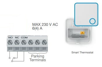

Hello,
I currently have a Worcester Boshch 28CDi RSF Combi Boiler and would like to connect this to my new Tado Smart Meter.
https://www.worcester-bosch.co.uk/support/literature/download/8716145020
Reading the manual, it seems that ST8 (figure 11) is the terminal to which I should connect the thermostat to.
https://www.tado.com/start/manuals/st/102022_E-ST01IB01-INSTALLER_MANUAL_RELAY-TA-UK-03.pdf
Off the boiler, where does Ns Ls and Lr connect to on the Tado terminals?
Can you please let me know which terminals to connect?

If it's just the Smart Thermostat you are installing as below, [ie not the extension kit]
Then you just need two wires connecting, the Tado Smart Thermostat doesn't need a neutral connection.
Ls (Live supply) goes to the Smart Thermostat 'COM'
Lr (Live return) goes to the Smart Thermostat 'NO'
If you have any existing controls they would need to be removed / decommissioned as appropriate.

You may find that you have damaged the boiler or the Tado. The three Tado terminals NO, NC, and COM are all live connections. If you put a neutral in one of them and have blown a fuse, you will have effectively joined the Live and Neutral wires together and created a short circuit :eek: Some are lucky and get away with it, others not so.
The unused neutral wire can be put in one of the 'Parking Terminals' to keep it isolated and out of the way. That's what they are there for. If there's an earth wire present also, that can go in another one.
LS - Provides a permanent 230vac supply to the controller and LR is the switched live demand back to the boiler. As a third party unit TADO would need to provide the correct connections for the unit to provide the 230vac switch back to the boiler"
So we both gave the same answer :) these are the only connections you need:
The link between Ls and Lr should be removed when the thermostat wires go in. The link is there so that the heating can operate when there isn't a thermostat connected. Inside the Tado when the thermostat switches 'on' the wires in NO and COM are simply electrically connected together by a switch, and effectively form a link between Ls and Lr.
Make sure that any other unused wires are isolated and not touching anything they shouldn't be.
The Tado is battery operated so I would expect the display to be fine, it's not connected to the 230V side. It's the 230V switch inside that can be damaged. What sometimes happens is that the internal switch contacts weld together because of a short circuit, but if that happened the Tado wouldn't be able to turn 'off' the heating, it would be permanently 'on'. It wouldn't however blow a fuse, so that will be something else.
