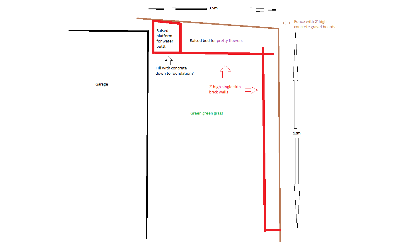

Still going on about my intended 2ft high wall to create raised flower beds!
As per the attached: intending to build a 2ft high single skin brick wall to create a raised bed against a fence that has 2ft high concrete gravel boards at the base.
One wall about 3m long to a corner, other wall approx. 11m long and worried about the weight of earth contained pushing the wall outwards.
Do you think I need to build some piers into it?
Will 'internal' piers on the earth side do any good or do they need to be on the 'external' side?
Will a single brick width coming out be enough or should I build an entire pillar?
Will also be placing a 235L water butt at the end of the wall also raised about 2ft, possibly supported on single skin walls with a bit of 6mm steel plate laid on top - walls alone should support or should I fill below with concrete?
Probably overthinking the whole thing but thinking means I don't have to get on with the hard work

I’d build a pillar or even a return that would be below ground every couple of meters.

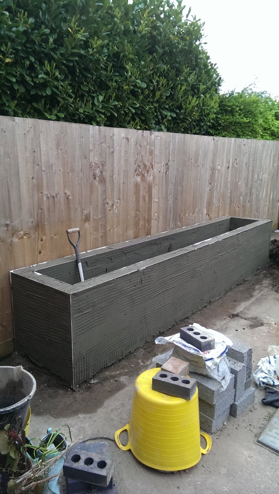

Do you mean like this (or something along those lines)? If so piers not required. It’s single skin block about 3 foot high. It’s full of soil but it’s fairly narrow and I don’t think the earth exerts much sideways pressure on the wall.

A bit of shape to the wall could make it many times stronger.
It's the first real brick wall I've built so don't worry it will have plenty of shape to it :eek:
As Ian said, will go with 18" high returns and try to tie in somehow to every other fencepost even if it's only with a long screw into the mortar line.
