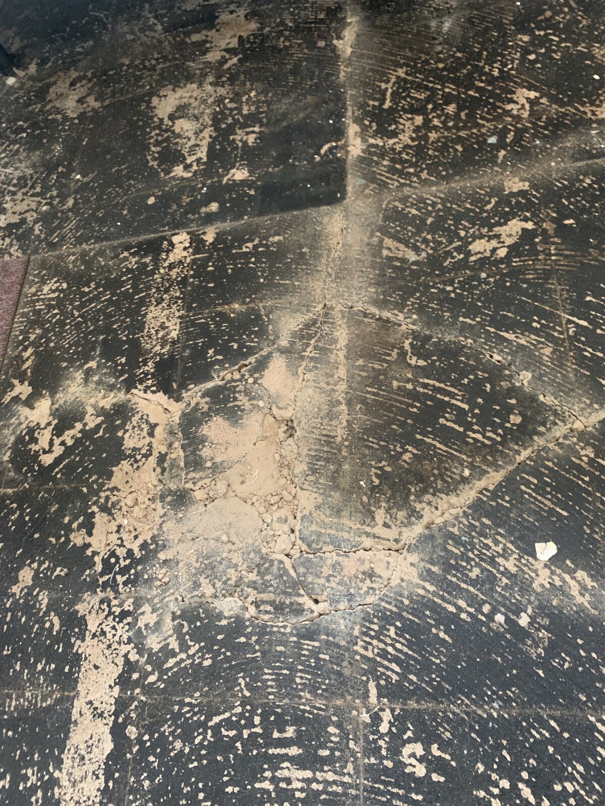

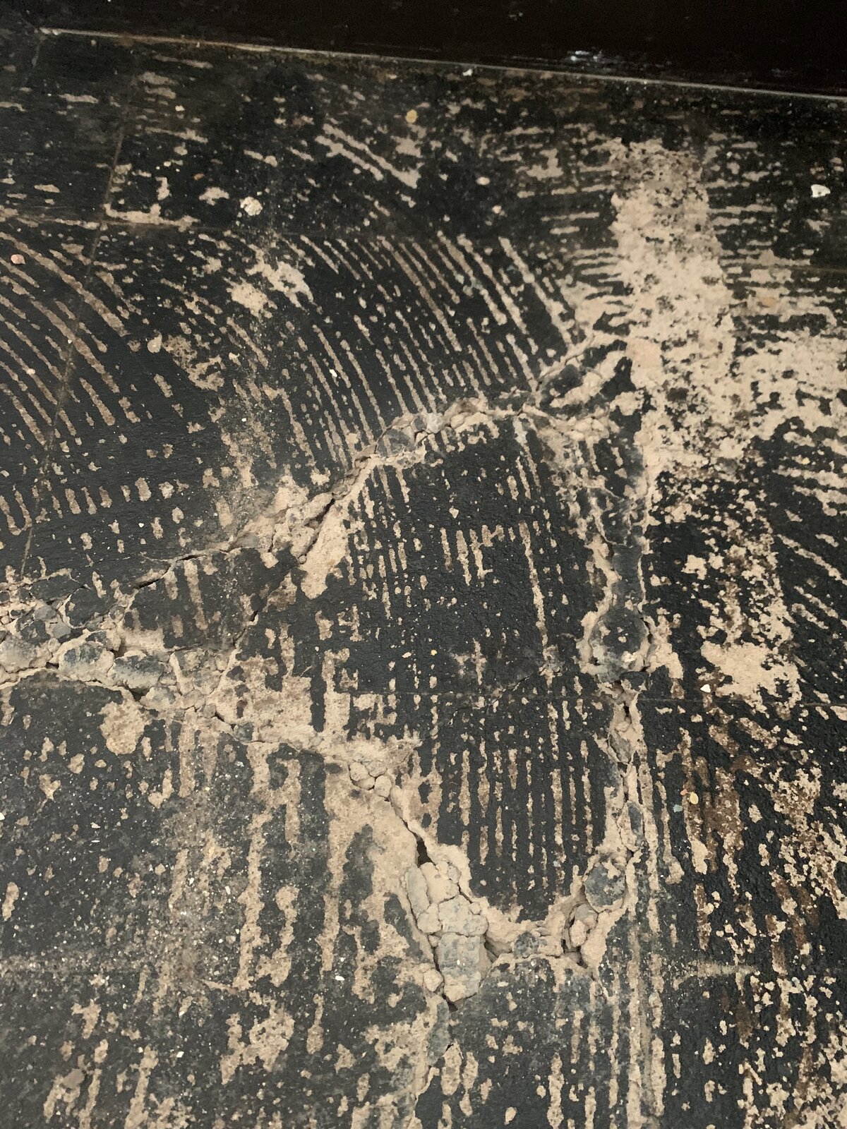

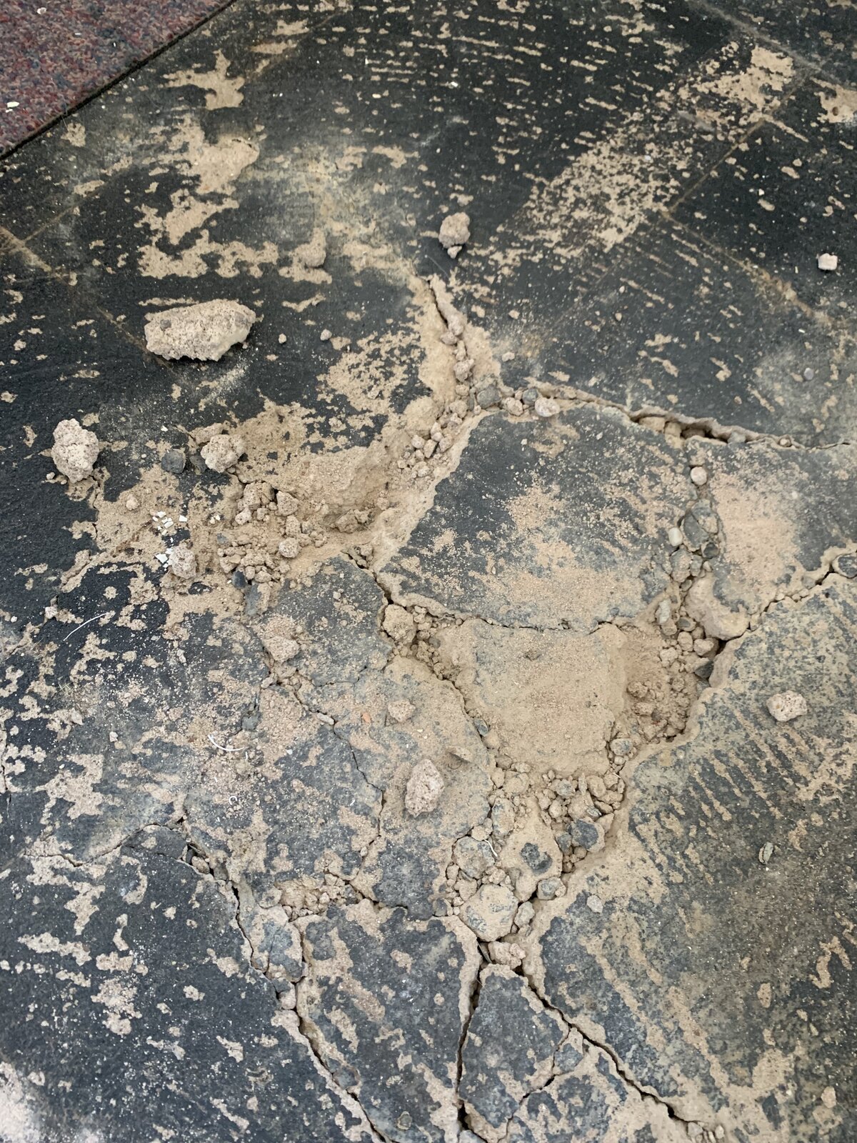

I have a 1960s 2nd floor flat. Removed old carpet tiles from the kitchen to find what I would say are quite significant cracks and deterioration. In parts it seems the concrete is disintegrating as can be seen in the last photo which was taken after some light brushing and makes me think it’s not just the floor settling (the debris is very crumbly). The damage is spread out across a couple of metres with the patch photo’s being approx 30cm. Can anyone provide direction to remedy this? I’ve read that covering it up would traps moisture and that removing and relaying is required but also that covering it up with the right resin based mix would sort

At a guess I assume the floor is beam and block (or reinforced concrete slab) with a covering of screed and its the screed, that wasn't mixed right or badly cured, that is disintegrating. You could try digging out one of the really crumbly bits and see how far down the "proper" concrete is (60mm?) and then decide the best way to tackle the issue. If it feels solid underfoot then may be best to leave well alone but if its shifting about it may be best to replace. There must be something in the lease about who's responsible for the structural integrity for your floor and the under occupants ceiling?

I did exactly that to which they responded to say the floor cracks and disintegration were because of the age of the concrete and due to thermal movement and that it is my responsibility to remedy. They also suggested a route to repair the floor based on a report a contractor gave them after looking at it for 5 minutes. I quoted the lease to them again and requested documentation to support their repair recommendations (such as test results from the concrete/ structural engineer report) and they’ve messaged back to say they will cover it as part of the service charge.
