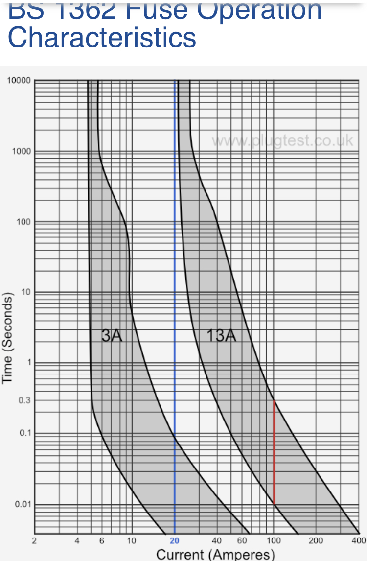

At full whack, your 3.4KW appliance will pull just short of 15amps.
Question: how long will it take a 13amp BS1362 fuse to blow if presented with a load of 15amps?
Answer: NEVER!!!
Crack on, it will be fine, even when cooking the turkey for Christmas!
Answer: NEVER!!!
That is true.
However the heating of the fuse and the plug need to be considered.
The cold resistance of a BS1362 fuse rated as 13 Amp is 0.0075 Ohms and the calculated heat produced in the cold fuse at 16 Amps is 1.9 Watt.
The resistance of the fuse will increase as the temperature of the fuse wire increases and this means that the amount of heat produced will be more than 1.9 Watts.
This may result in damage to plug and/or socket when 16 Amps is flowing for prolonged periods of time.
