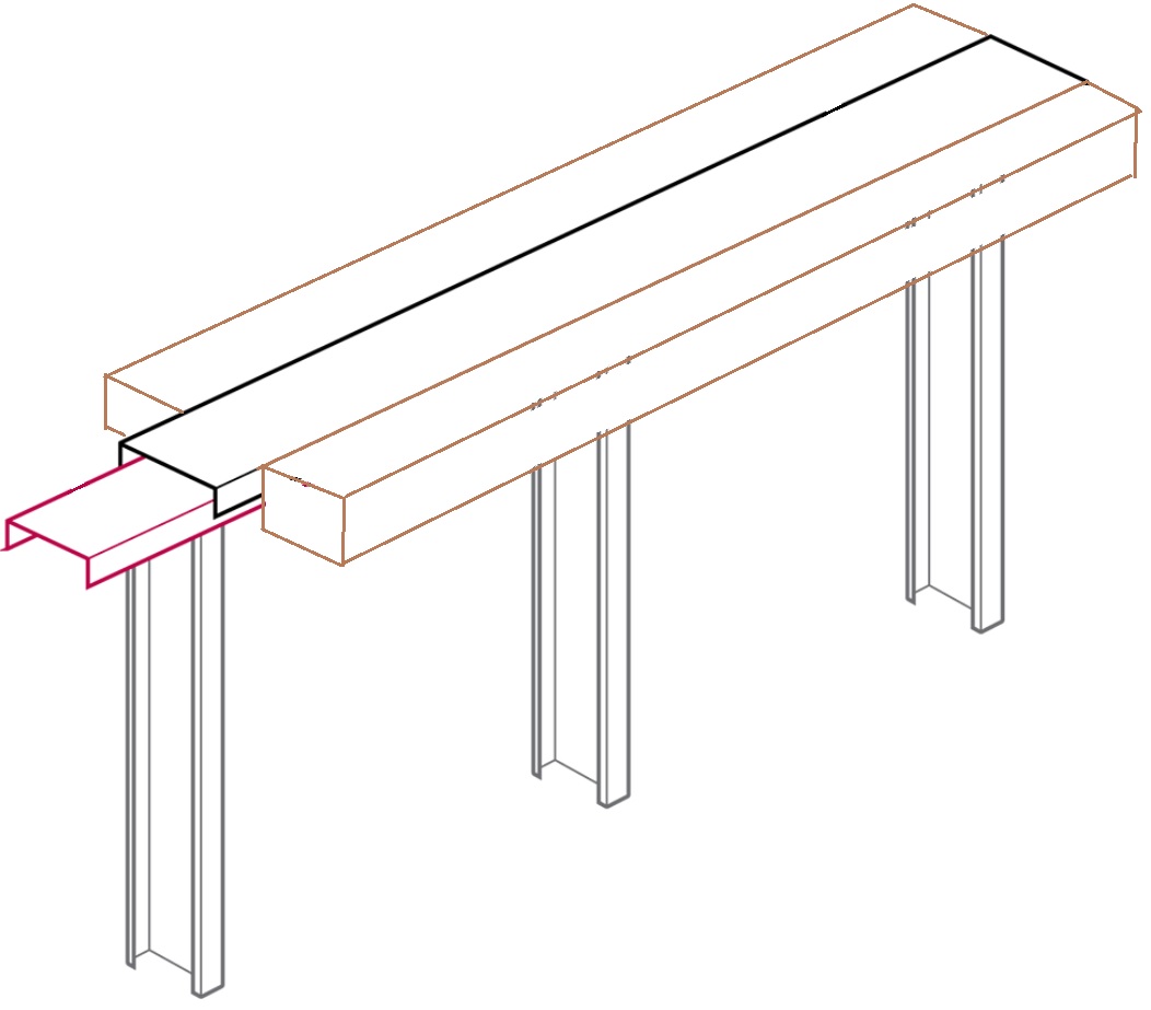

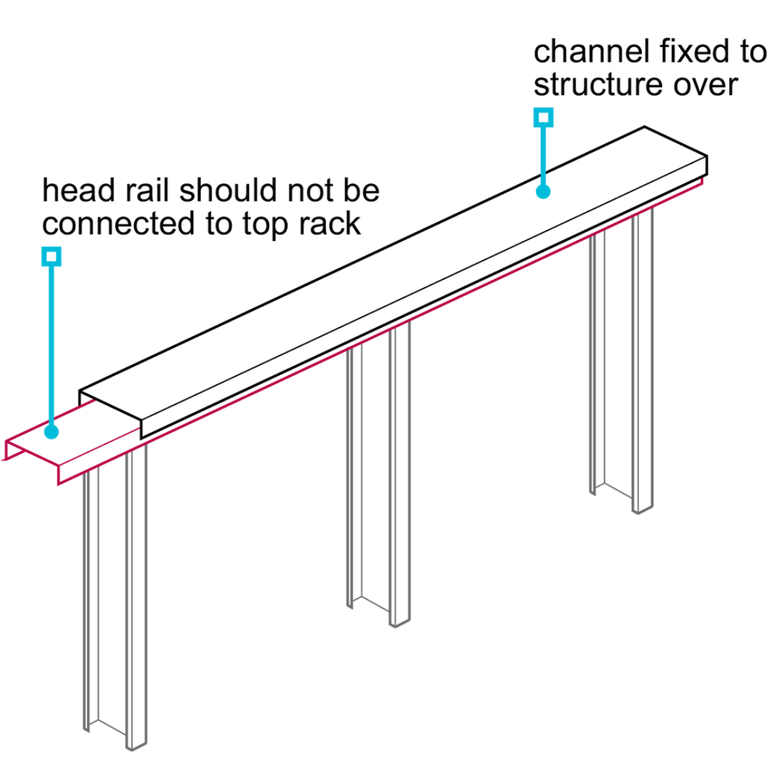

The plan is:
Mortar layer on the existing party wall (exposed brick visible joist level)
Treated timber sole plate (nail/screw as post suggests)
Timber foot.
Metal frame (non-load bearing/deflected)
Fire boarded.
Insulated.
Only need 1-hour fire rating but this should achieve 2-hours plus!

It goes upto the ridge but only the deflection head is fixed. It allows for roof movement so the wall doesn't accidentally become load bearing but the wall isn't actually attached to the ridge.

You can still sprag off the underside of the rafters using short lengths of timber (for stability).
