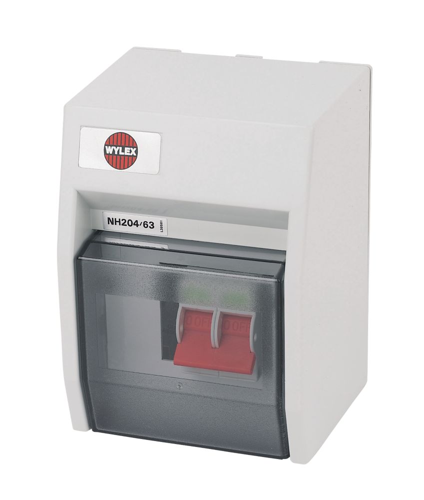

After 13A we jump to something like this
ae235
the fuse carrier jumps in size
so needs a massive box so normally it's mounted in the main consumer unit and an isolator
and a cooker connection unit
are used instead. Only in the UK is the ring final system used rest of Europe uses radial circuits so once you leave goods designed for UK than you have to use the European system sorry.
