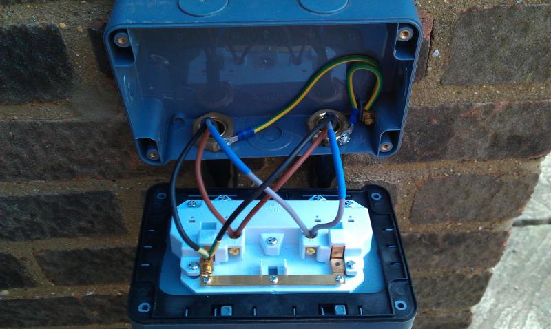

With regards to 3 core SWA and sheath earthing.
Is it best to keep them separate or cross bond them?
It doesn't need a link from the armour to the earth terminal on the socket if thats what you mean, but it wouldn't do any harm to fit one.
And none of what you are talking about is cross bonding. That is something completely different which serves an entirely different function.
It doesn't really matter about cross connecting the armour to the cpc core at every accessory but it needs to be earthed at source (or elsewhere) and be continuous to ensure of earthed mechanical protection.
Of course using the armour and seperate core in parallel will keep the earth fault loop impedance low.
I would link the sheaths to the main earth connection at this point, in case someone removes the earth connection from the sheath somewhere else. It does happen, when someone replaces a metal box for a plastic one, for example.
Cheers all.
So it doesn't need it, but nice to have belt and braces!
Thanks again.
I would use belt and bracer's unless good reason to not link for example clean and dirty earths.
