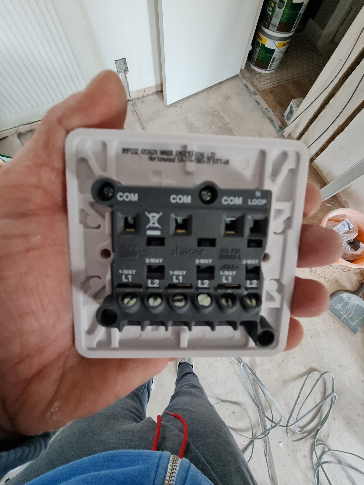

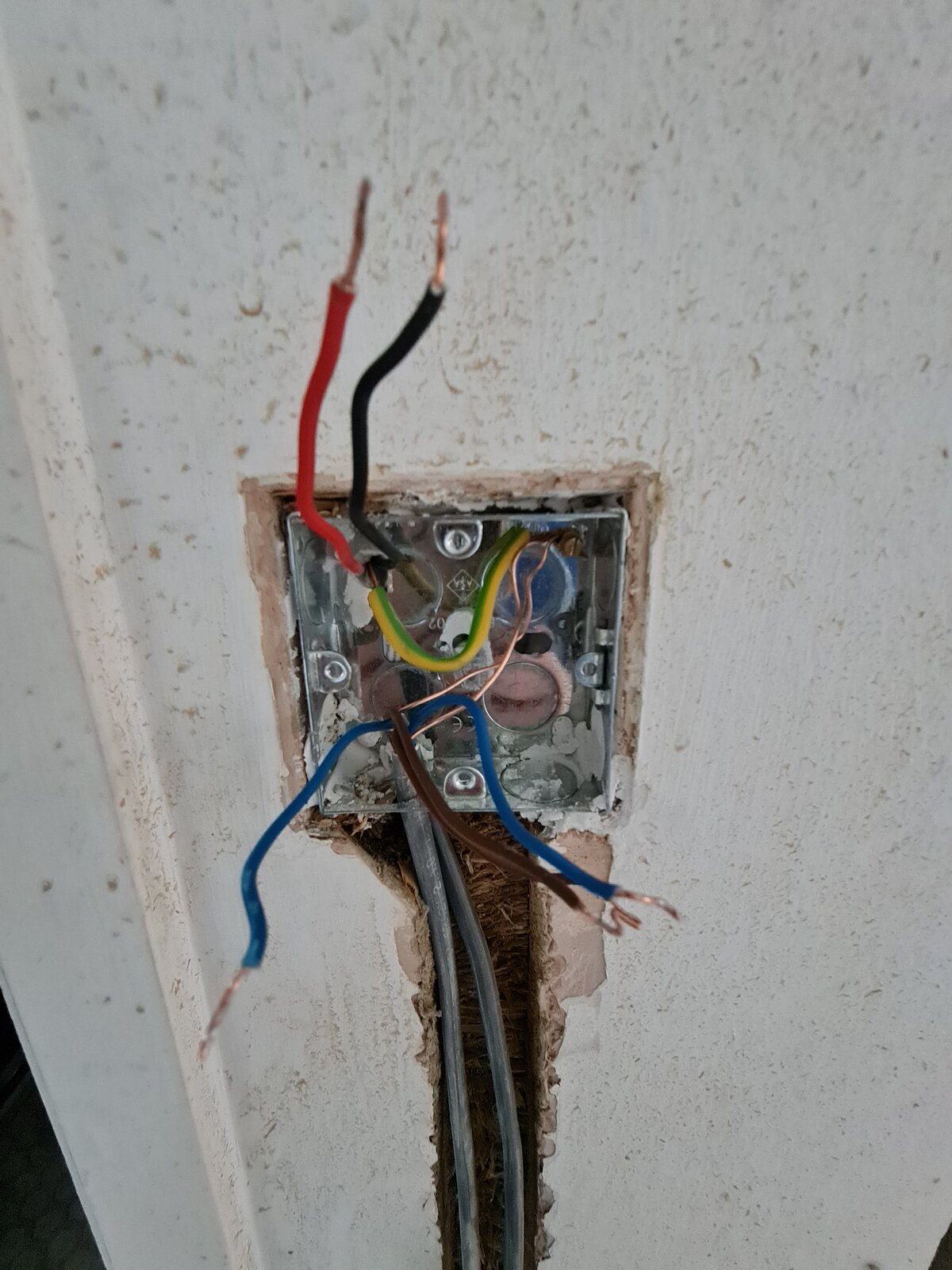

Hi everyone.
I'm trying to make a 3 gang switch from 1 gang switch.
1 stays as it is to operate a lights in the kitchen and another two for plinth and under cupboard lights. The two new additional circuits will end with a socket to which I want to plug in a LED lights - that's the ideas. Unfortunately I do get a L-E reverse on them I don't know how to fix it. I tried everything. I'm not sure if that's even possible to do now. Please help.
I've attached to pictures. If you need me to explain that further I'll do my best to do so.
Your number 1 problem is that you don’t understand the wiring. Your light switch does not have a neutral. Without a neutral the additional circuits cannot work.
The existing light cable (the red and black) are live and switched live. The black is. Not a neutral!
The existing light is loop in at the light, that is where it gets its neutral from. You’ll need the replace the existing 2-core and earth cable that runs to the light fitting with a 3-core and earth cable. The third core will take a neutral from the light fitting to the switch and you are then sorted.
Sorry, more wall chasing, floorboard lifting etc to be done.

If there is a socket circuit already near where you intended to plug the new lights into, you may be able to create a way of using those two new cables as 'switch wires'.
If you can get a feed from a nearby socket, near the cupboards, there may be a way of fusing down via a 5 amp FCU, to control two new seperate sockets - each of which could be controlled by the new switch wires.
It would mean the 3 gang switch would have two seperate circuits within it, but that's ok.
It might save more chasing and getting above the ceiling.
