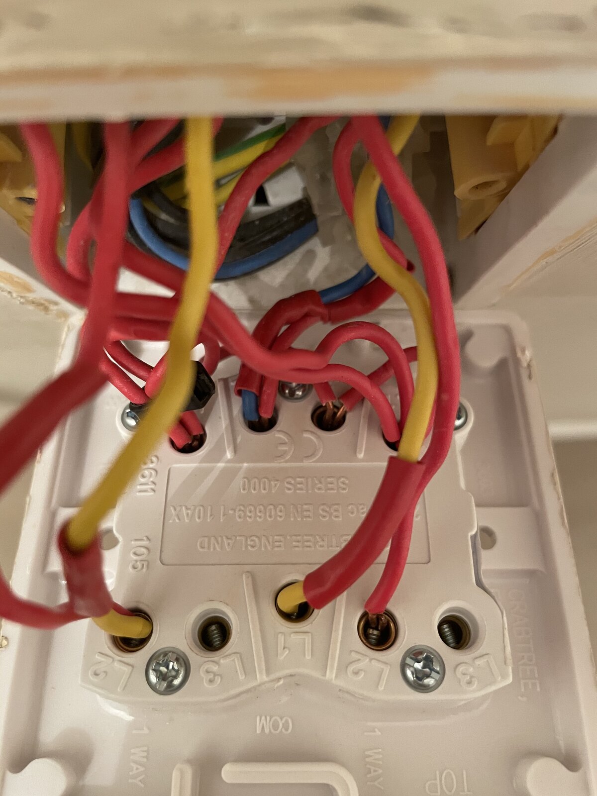

Hi. I’ve reviewed previous posts on this subject but I’m struggling to find a solution to what is probably a common problem.
I have 2x 3 gang switches that I’d like to replace with a Smart Switches.
Downstairs the 3 gang operates a light in the hallway and an outside light and also has a 2 way switch operating a light on the landing.
Upstairs the 3 gang operates a bathroom light and an attic light and also has a 2 way switch operating the same light on the landing that the downstairs switch operates.
Try as I might I can’t get the 2 way element to operate.
Any help would be appreciated.

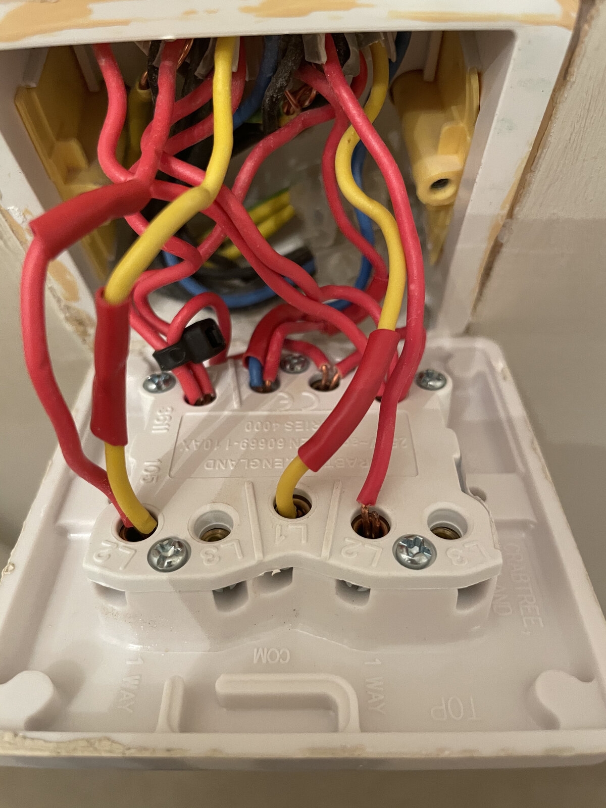

Are the pictures upstairs or down?
Picture of the other switch please.

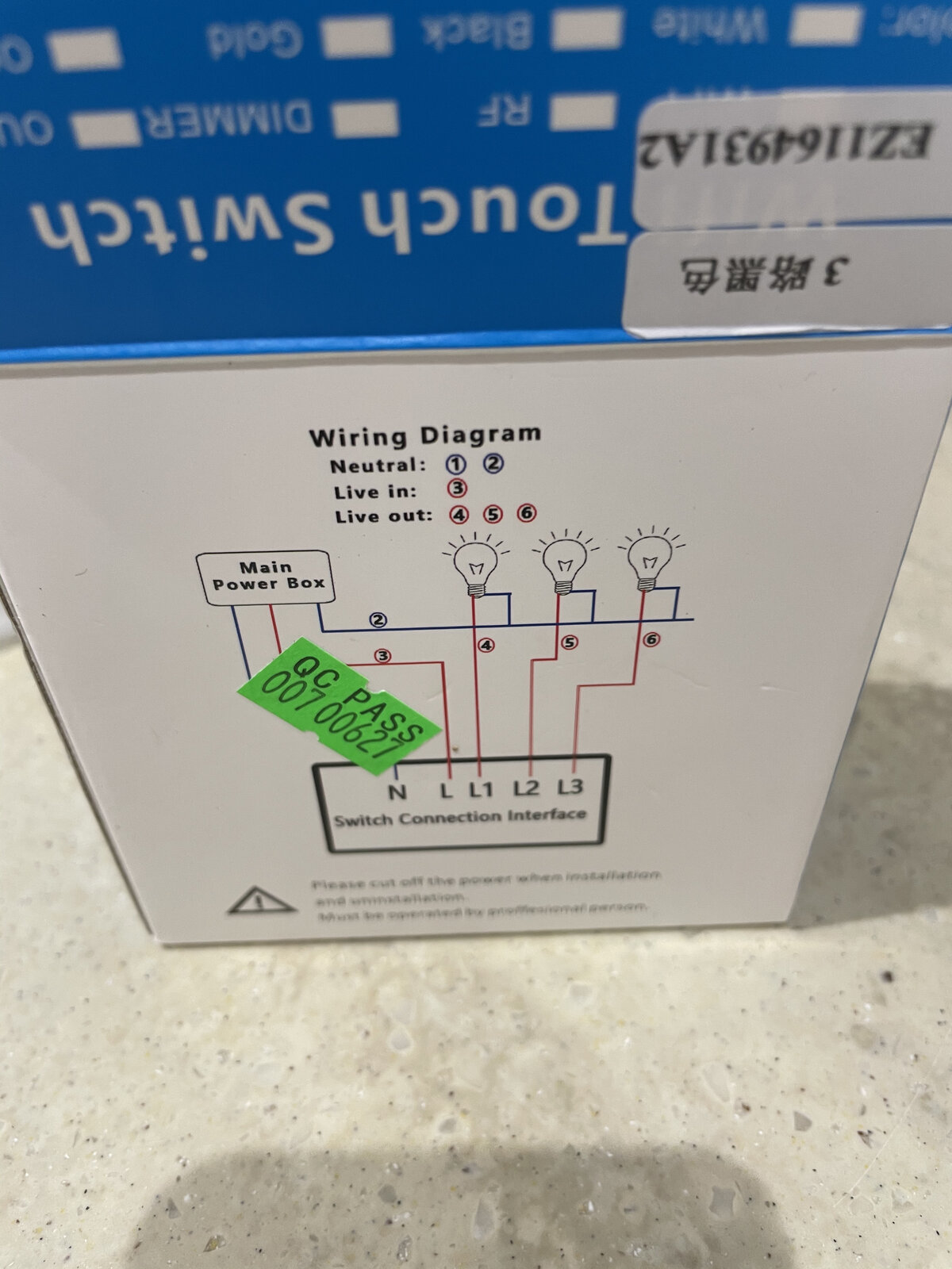

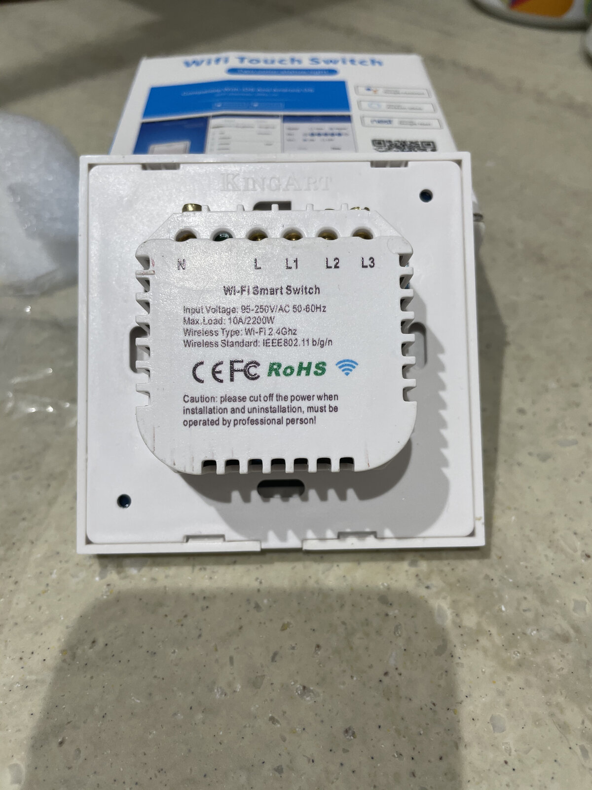

Hi. Thanks for the quick response. Using the current “standard” switches the setup works fine but it’s setting it up with the Smart Switches that I’m struggling with. I’ve had a look at the upstairs switch and it’s identical to downstairs. The Smart Switches I’m using are non branded and I’ve included some photos below. The suggestions provided are for a more standard setup by the looks of it.
The existing switch is a 3 gang, 2 way switch.
That 'smart' effort is not - it's a single switch with 3 separate outputs.
Any control from multiple locations will require that the individual switches are programmed in such a way that you can only have one of them on at the same time, and that operating one of them signals the other one via whatever means it has to do that.

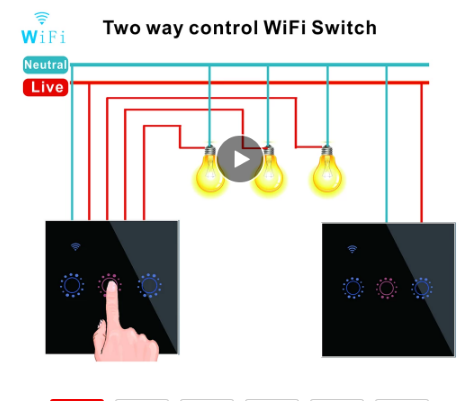

Of course, with smart switches you don't need two-way circuits.
The five lights could be controlled with two switches like you have pictured although might be inconvenient for the stair/landing light only able to be operated by touch from one location.

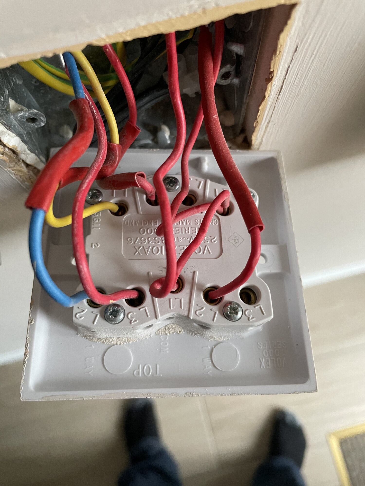

Can we have a picture of the other existing switch saying which is upstairs and which is downstairs?
You say both switches are wired the same but that doesn't seem likely from the picture we have.
Probably worth mentioning as well, the common switch (I.e. the one that controls the landing light on both) is the one furthest left on the picture.
Again, probably don’t need to tell you but the middle switch is the common one. Thanks for any support you can offer in advance
This is from the same make of switches.
It seems they can work as two-way with no wiring between.
So, perhaps they can be configured to work as you want. I don't know; I cant find any actual instructions.
