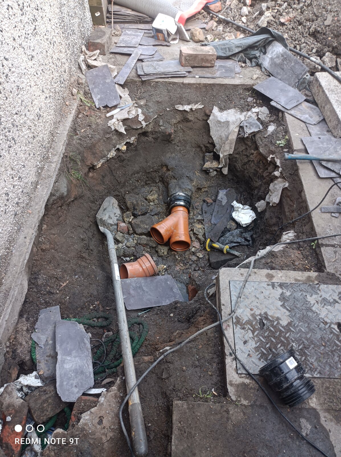

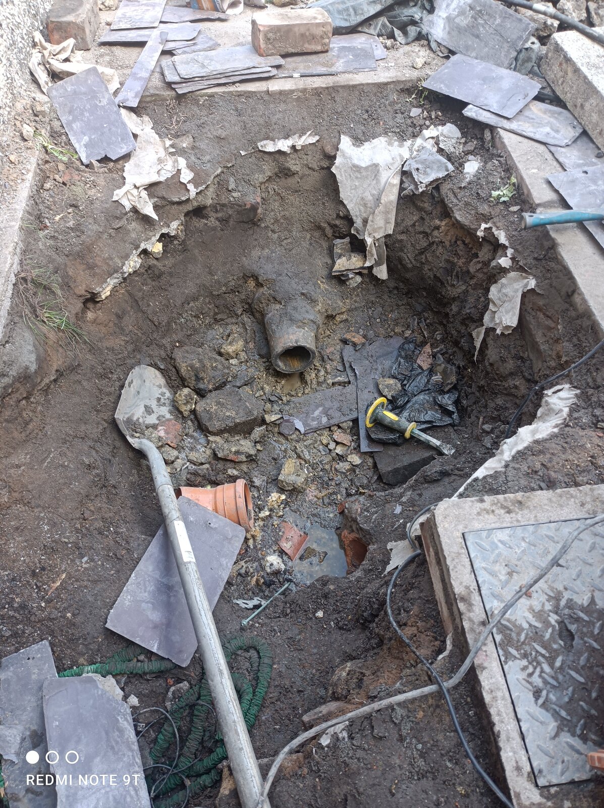

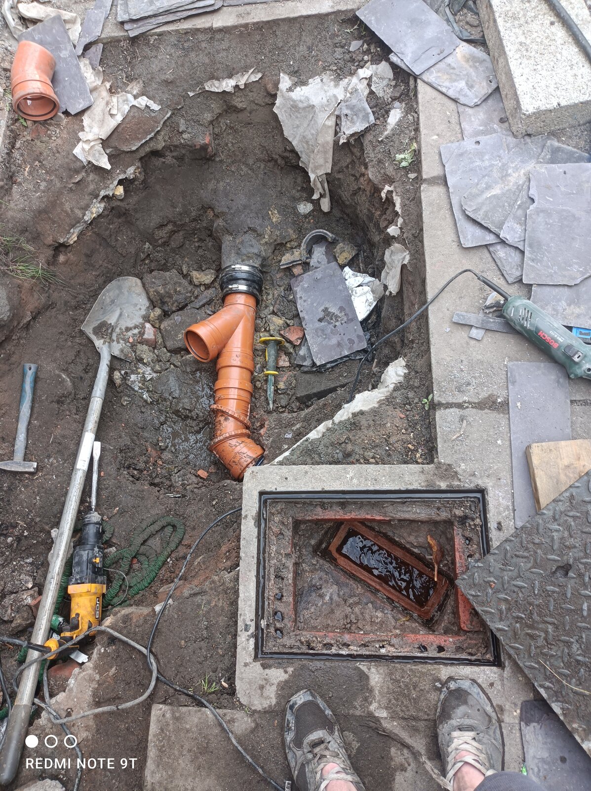

Hi There ,
Managed to open up and fix a collapsed 1900's drain , thanks to this forum and YouTube ( clay pipe in 2 foot of concrete would have cost a fortune and has multiple no shows anyway )

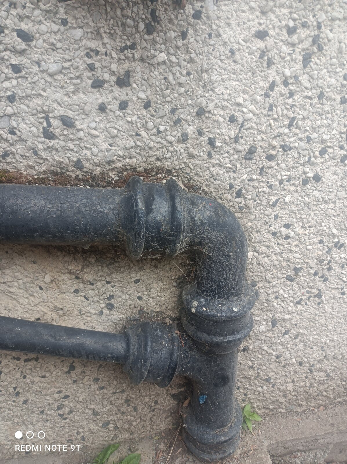

Anyway, Addition to the sewer is a run from the washing machine , it goes into a cast iron gutter pipe that's 3 inches ( just under )
This appears to be too small for any of the connectors In can find in the big stores / jewsons etc , for the other parts I used icon, Flo plast etc, but all too big for the small diameter of the cast iron down pipe
Perhaps I'm looking in the wrong places for a connector ? Ideally I want to buy in person , or is there a work around ?
So looking for a connector for a 3 inch down cast iron - to plastic
Thanks in advance
Attached, first one is the cast iron that to switch to regular pvc underground

One side yes, it would attach well to the cast iron , but the other side is the standard underground PVC (110 ish)
Must be missing something , and the pvc to clay ( 4 inch ) really common ...
Superb yes , essentially what I'm after .
I'll either order that ( Shipping not cheap ) or v similar , just glad it exists . Looks like I'll have to get it to go into regular pile then a rest bend but either way it's good .
Any idea why 3 inch Cast iron to pvc a bit rare ? 4 Inch obviously much more common - shame need to order online and risk incorrect etc
Thanks again
