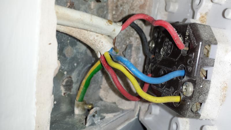

Yeah sorry, reading that back it is a tad confusing!
I have 1 double gang switch (as in one plate, two switches) in the living room operating the living room light, and the dining room light. Open plan arrangement
Then I have another double gang switch in the dining room operating the dining room light, and the hallway/stairway light
I wanted to swap the living room switch out for a dimmer, that would dim both living room and dining room lights

Yes, easy to change make sure you buy a two-way dimmer and that it will handle the load you require to dim.
Rememeber to take a picture before you remove the old switch.

Thanks Kevin, bought the right thing
I am a little lost as to which wires go where though?
Speaking of pictures...
I'm fitting one of these:
227374_R_Z001
Which looks like this on the rear:
Ignore the wires
First thing to do is check your new switch will actually fit that back box, as I suspect it probably will not.
As for your diagram, turn the right hand switch upside down, and that's how your existing switch is laid out,
