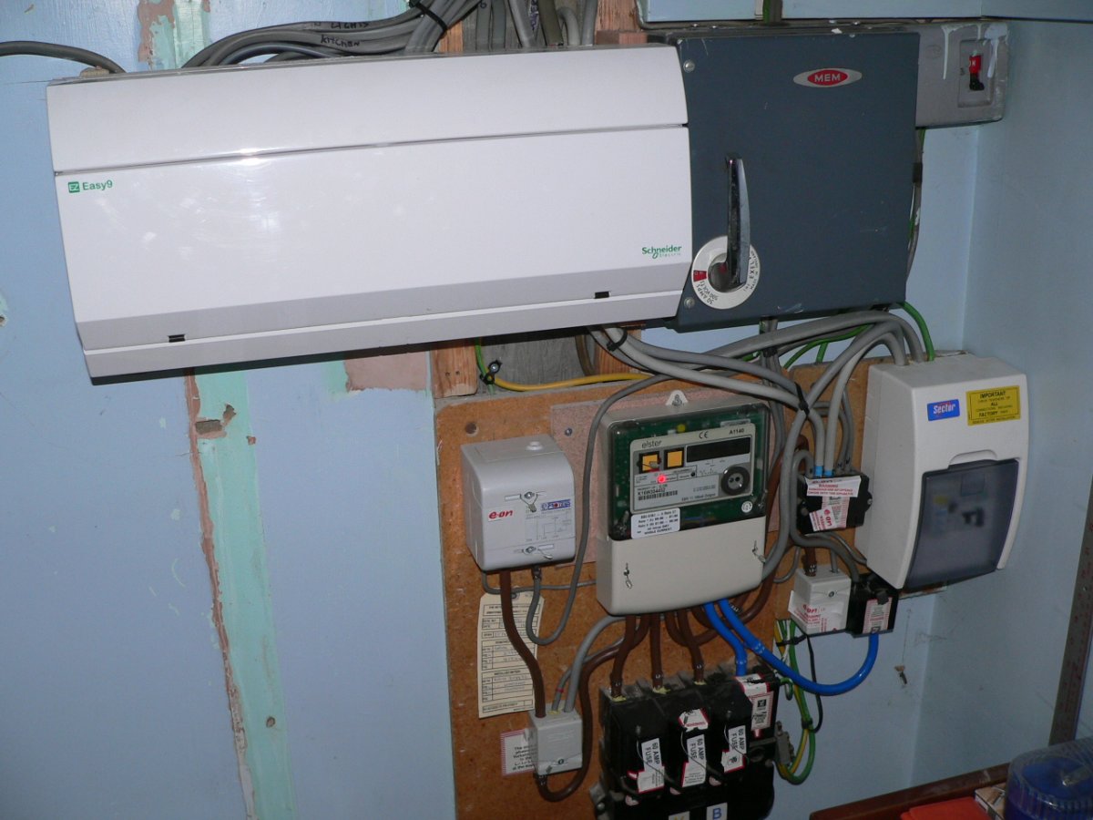

The property we are renovating has a 3 phase-fed, off peak, ducted, warm air heating system - and it works surprisingly well. It has a single phase immersion on the off peak as well and a normal tariff daytime top up.
That's the easy bit.
The house is a being extended and completely rewired. (largish three bedroom dormer, large garage/loft, workshop, outbuildings, etc.
I'm also going to install my old 3 phase machine tools in a new workshop.
The original domestic (6 way) consumer unit was an ancient Wylex with wire fuses and fed from one phase.
The electrician has done most of the new domestic wiring and replaced the consumer unit with an 13 way split load unit - but still fed by one phase.
The supply for the heater and immersion is still on an ancient MEM ceramic/wire isolator - from all 3 phases - no RCBO/RCCD protection whatsoever and is about to be replaced. He has produced - and I've paid for - a large (expensive) Schneider Acti9 Isobar distribution cabinet, with 12 three phase outgoing ways - as in 36 terminals.
Trouble is………. he's baled out of it.
My questions are:
would it be better with the 'domestic' side of it split between the phases (at least two of them)
where is the best place to protect this lot?
how is the wiring for my new workshop and 3 phase machinery best laid out?
Doubtless there will be other questions as well.
I want to understand what any future electrician should be doing. Rewiring the rewiring is not what I'd consider a useful way of disposing of my limited funds.
Given time and research, I'm confident I could do it - but it will still need to be signed off.

There is a problem using three phase with domestic, where a system is under the control of ordinary persons then we need to use type tested distribution units called consumer units. These have normally a maximum current rating of 100 amp and are single phase, domestic electricians are normally members of a scheme which requires them to follow BS7671 and to deviate they would need permission. So it is possible that the scheme provider will direct them as to what three phase panels they will accept it is really a can of worms.
The three phase system should be balanced and theory would say the house should have a distribution unit which supplies items so in the main the supply would be balanced, but since you have to use a consumer unit this can’t be done. So all other buildings, will need to have the phase used in the house, arranged so that phase has the lightest load.
The alternative was is not to use a scheme member electrician but go through the LABC who do not need to follow BS7671. Although doing that means you have no idea of the skills of the electrician.
So if I was not skilled I would select a firm of electricians rather than a sole trader, the firm will likely have a mixture of electricians including ones who normally use three phase, and the firm is likely to be able to get their scheme provider to wave the restriction of BS7671 in some way, likely they will agree to be your electrician and then they become the responsible person not you.

No. A pic would help.
Here yer go
The meter and all the terminal blocks are new, fitted a couple of months by eon when they replaced the old meter. That was done after the new consumer unit, etc was fitted.
The MEM isolator is the one described and switches the off peak units.
The incomer fuses are all 60 amp, not 100
Pat'sPatter
Plastic consumer unit? No pride taken in the install at all.

Thanks for the advice ericmark. The 'farm electrician' option sounds about the best. I'm surrounded by farms.
The 3 phase panel is a good one, I've paid (quite a lot) for it, it's well OTT for the job but that never hurt.

Err… aren't most of them, these days?
Ooerr, error! There not, are they. Hmm, now you mention it, it does look a bit nasty, I agree. It wasn't the sparky's fault, though.
PatsPatter
Not since 1st January. They should be made of a non-combustible material (or in a non-combustible enclosure), which every manufacturer has taken to mean metal.
……….. in which case, it'll get changed.
Now.
Anyone want a 'heritage', one owner only, plastic consumer unit?
PatsPatter
What I don't understand is why everything isn't all going into the lovely Schneider 12 Way TP+N board? And why that Sector POS is still there
