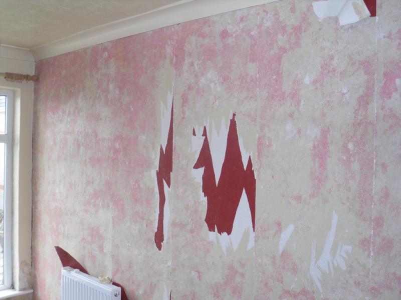

Hi,
After some help from the building forum I have split a room with a stud partition.

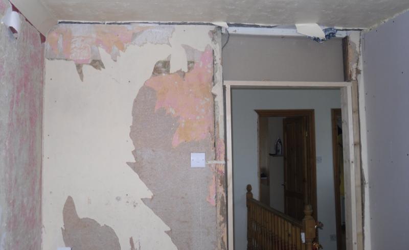

I now have in both rooms, 1 new stud wall, 2 walls with old bumpy plaster, 1 wall that was covered in ply. Under the ply I have found what seems to be very old PB or cement board. There was only ply above where the door frame is now, so will def need some pb in there.
I was going to wallpaper but now the missues (who is due this weekend) has decided that she would prefer it just painted and does not think lining paper will be good enough.
So, firstly, what should I do?:
1. Skim the whole lot (as a newbie could I do it myself?)
2. PB the other 3 walls and Easyfil the joints
3. PB the wall that had ply on it (the one with a door hole), Easyfil this and the new stud wall. Skim the other 2 walls.
3. Just use lining paper

Old plaster walls:
Door hole wall was covered in ply:

if the misses wants a good finish for painting :( then just get a pro in to skim all the walls..it will be done in quick time and proberly in the long run save you money.
if you want any advice just ask im in the midlands ;)
phil
depends on budget really i think, you could spend considerable time filling and sanding and papering and still end up with less than ideal results, insideout is right a pro would be in and out of there in a couple of days, room completely skimmed for around £350-£400 inc. materials.
PB the ceiling and skim it, this is quicker than easy fill and no sanding involved, you wanna keep dust to a minimum really and what you are planning is enough dust without rubbing back easyfil.
Get it skimmed now if you can afford too, it's the best way, once you put paper onto plasterboard you wont be able to skim onto it.
This room looks quite small, if you were to board the ceiling then skimming it is an easy days work for an experienced spread and materials shouldnt cost a fortune, or have a crack yourself!
Hi,
Thanks all for the advice, based on this I had a spread around today.
After tapping on the walls he thinks quite a lot of the existing plaster is "hollow" (not bonded well to the wall I understood it to mean). He gave two options, either take all the old stuff off and start from scratch or board and skim. He said if he just skimmed what was there it would crack. In the end he thought boarding would be best.
He quoted £450 for the labour (2 men for 2 days) and it would cost me another £200 for the materials. This is to board and skim both rooms (inc. the ceiling) - they are both identical rooms as the one big room was split down the middle.
Does this plan and the cost seem OK?
Cheers,
Jim
Price seems competetive, can you eleborate on what is meant by 'board' will he be dabbing over the old blown plaster, if so, that isnt a great idea, or are they going to batten and board?
