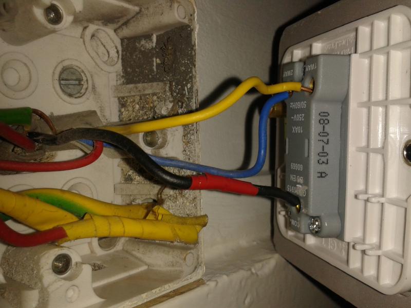

Hi,
In my living room I have a double light switch that controls the living room light. On the other side of the living room door I also have a double light switch that controls the light in the living room. They are both double switches and yet they only turn on one light.
So I've bought 2 two-way single switches to replace them, but I have no idea how to wire them up because it looks like they've been wired in a 3 way set up?
Any ideas would be good, I've attached the wiring of the switches as they were before I took them off the wall.
At first glance the wiring does not seem to make sense.
Have you moved any of the wires?
In the left hand picture, does the 'top' switch control anything?
The bottom photo is just controlling one light, so it will simply be a matter of exchanging the wires like for like.
The photo you have posted appears to show

In the left hand picture the top switch doesn't turn anything on. The bottom switch turns the light on.
I think the light switch in the left pic is the original light switch and the switch on the right pic has been added afterwards. But I'm not sure how they've managed to wire it up.

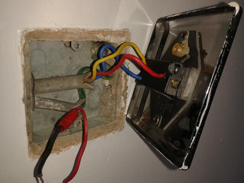

Okay, this was the initial set-up with a plastic front on it:
And that was a double switch for an outside light (not connected up) and the living room light. Now it looks like this:
So am I correct that what I need to do now is earth the light switch with the green and yellow earth connected to the back of the light switch and tape off the unused black and red wires?

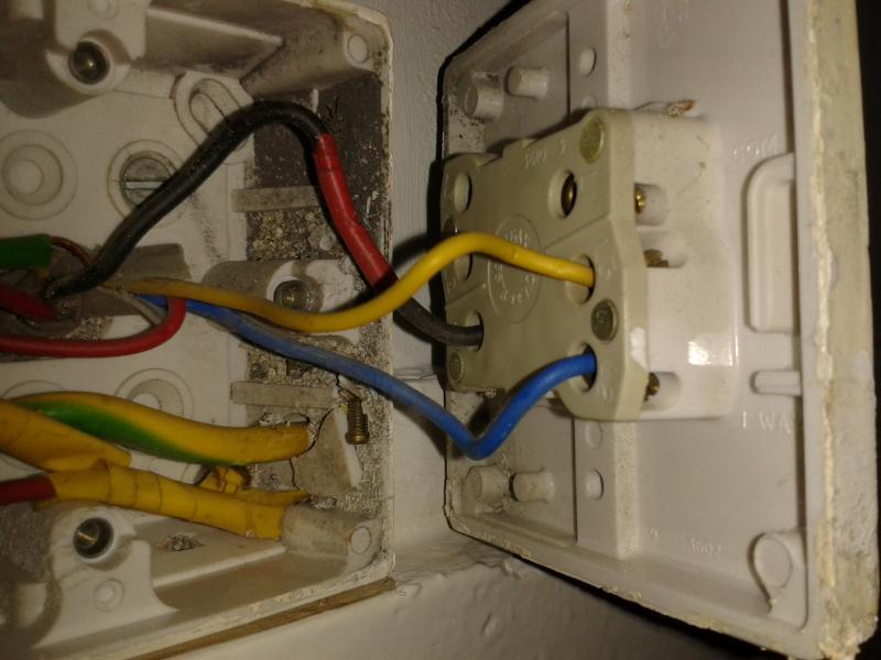

Now the other old plastic switch that looked like this:
Now looks like this is:
That earth wire is too short to reach the back of the switch so do I need to add more earth wire so it reaches to the back of the switch?
Yes, to both of them.
Put each of them in a separate connector block.
Yes.
So the 3 R/Y/B cores are now connected differently to how they were before.
Yes, you need to earth the switch, having proved that the cpc is connected to earth.
Use choc-block on the end of the unused cable, not tape.

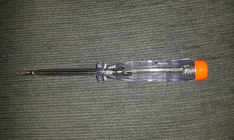

I've got a continuity tester screwdriver how do I check continuity back to the CU?
Do you mean a 2-pole continuity tester screwdriver, or a neon screwdriver?
Yes, the 3 R/Y/B are on one switch now whereas before the yellow wire was on a switch with the black wire (For the outside light) and on the other switch it had the red wire and the red wire (For the outside light) and the blue wire connected to it, as you can see if you follow the wires back:
That's what confused me because the wires were spread across both switches even though only one switch controlled the light.
I will use blocks instead of tape on the red and black wires that are not connected.
The earth does reach the back of the switch so I've connected it to the back of the metal switch now.
The screwdriver I've got is this:
