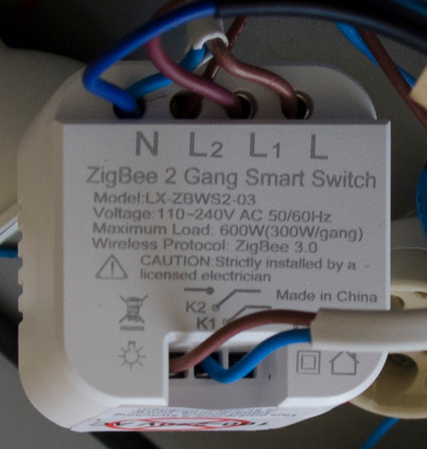

5) Because often no neutral at the switch, you can also use a relay, DSC_6061r.jpg this can be fitted at the light rather than the switch, and means all switch wires are extra low voltage, and the mobile phone can switch the light on/off and all switches so you get best of both systems. I use the one shown for landing lights with Nest Mini and voice control, wife loosing use of her fingers now!
