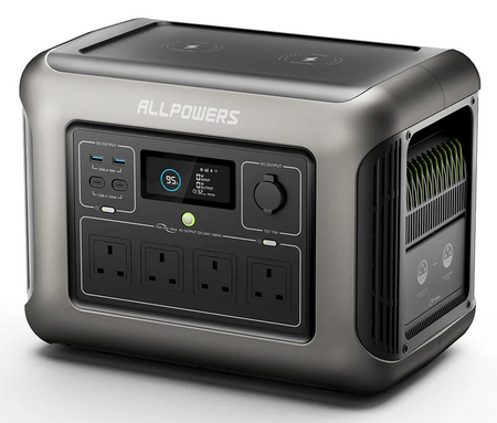

There are special inverters, only seen them used with narrow boats, it allows one to use a small supply, typically with narrow boats 6 amp, and charge the batteries typical narrow boat would have 4 x 160 Ah, and use the batteries on peak demand, today there are also stand alone units with lithium batteries, these also allow one to power from low current mains supply or solar, and for a short time have a high power item running.
My own home has this, so although my DNO fuse is 60 amp, with the battery I can draw 72 amp, and if sun shining as well, around 90 amp. It is not designed with this in mind, it is just a side advantage of having solar panels and a battery, if the battery is discharged then there is no extra power. Units like this 1724080648210.pngcan be configured to supplement your supply at peak demand times. The modern lithium battery will normally discharge 1/3 more current to what it can charge at, and a unit around 3.2 kWh will deliver around 3 kW and charge at 2 kW, so will discharge in an hour, and recharge in an hour and a half.
