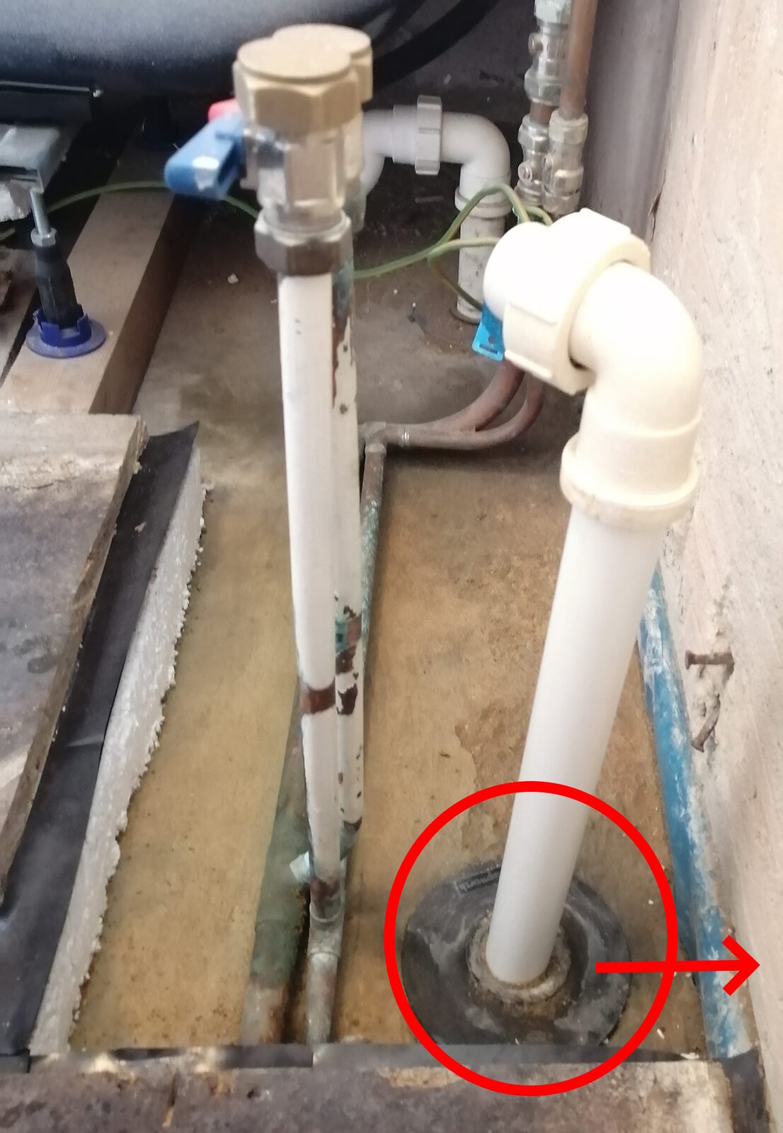

I need to move this 32mm basin waste into a wall chase without having to dig up the concrete and rework the soil pipes (see pic)
Ideal solution would be a 90 degree bend where the pipe exits the soil pipe boss; however, that arrangement would be higher than the floating floor.
Can you get lengths of 32mm waste with a 90 degree bend, or a recessed soil boss that would allow a 90 degree solvent weld bend to sit slightly inside? Both may lower the overall height?
You do get a spigot bend that may do what you are planning, trimmed to desired height
That should work quite well. Not sure what the length of the spigot is to go into the boss, but I could always add some the other side and insert the pipe & boss into the soil pipe as one unit.
