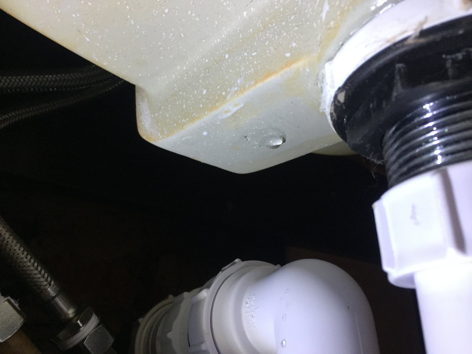

DOH.....all plumbing done and when turned the tap on it turns out there is a weak spot underneath the basin itself.It drips.
I cannot take the basin back as it has been more than a year i purchased it.Is there any epoxy resin i could purchase to fix it.
Is there a crack in the basin ? Where exactly is the leak ?
The crack is in the body of the basin just behind the waste hole underneath.It looks like a manufacturing defect to me, as it is in a round shape and have tiny holes.When the tap is on it drips heavily from this.I would say it is the size of 1p coin.

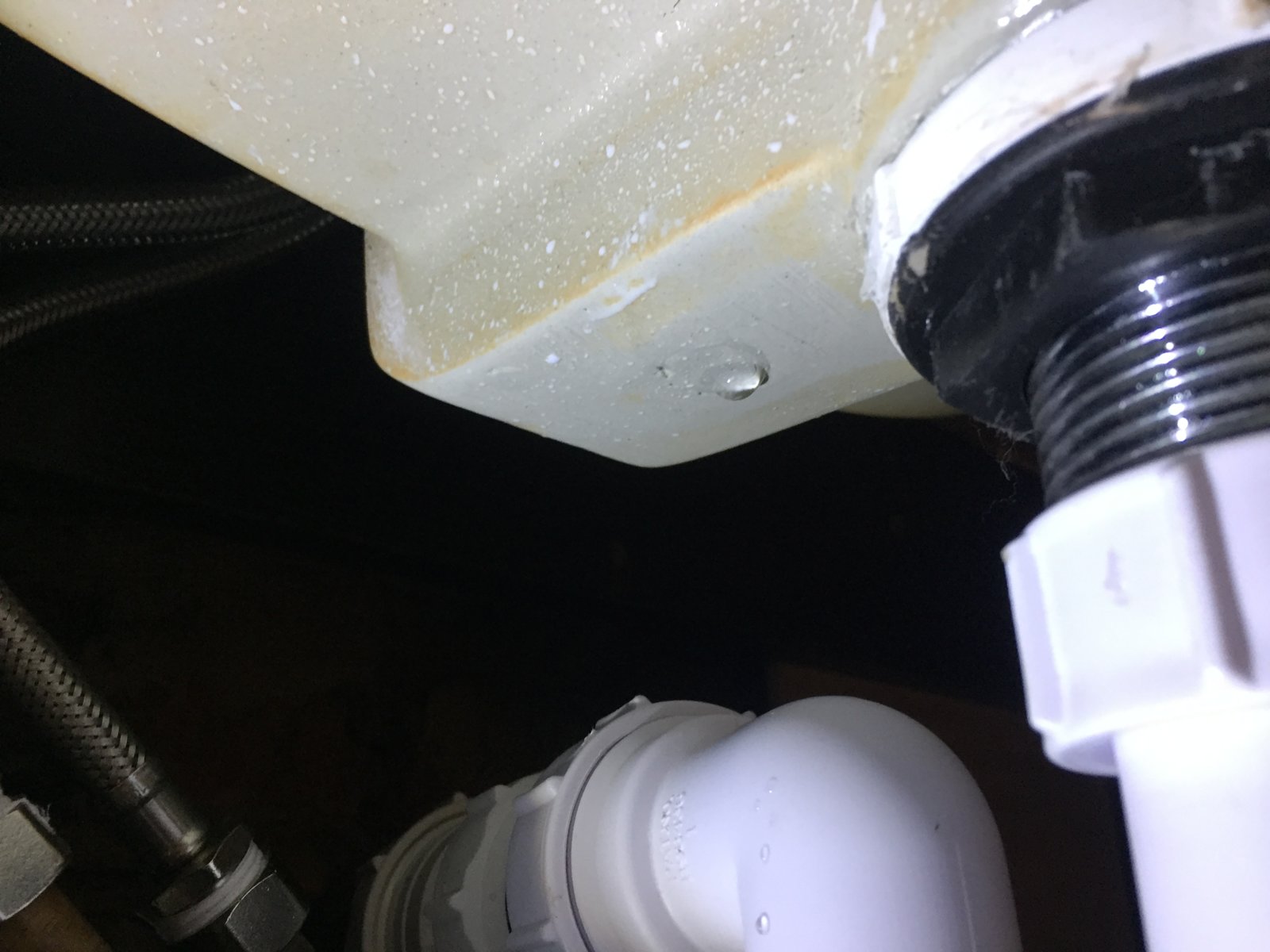

drip is where it leaks.It is a round hole and the area is just above the overflow on the basin.If i remove the basin waste then this area is hidden from above.
From that photo, it appears it would be a manufacturing defect, proven that it existed before with photo, provided you have your receipt or proof of purchase (bank statement) then you would be able to return.
uploaded again.
