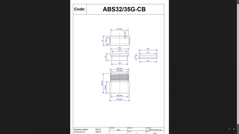

I emailed McAlpine and their reply was a little disappointing, but understandable. They wouldn't commit to a yes it'll work/no it wouldn't, but stated the part comes with two seals: one to suit 32mm OD pipe and one to suit 35mm OD pipe. They also attached a technical drawing.
If the mods don't mind (copyright?), I'll upload the drawing here for expert analysis. :)

I found a branch of Plumb Centre that had these in stock so I could check it out. McApline told me it came with two rubber rings, one for 32mm pipe and one for 35mm. Unfortunately, PC said they only come with one fitting and that was the 32mm one. So the pipe wouldn't fit.
I think the fitting would have worked, if it'd been supplied with the seals the manufacturer claimed it should.
After discussing the issue with PC and a couple of plumbers that were shopping there, I went with a compact, 32mm compression coupling. It was almost a perfect fit in my 50mm hole and somewhere I can easily access it should the need arise.
