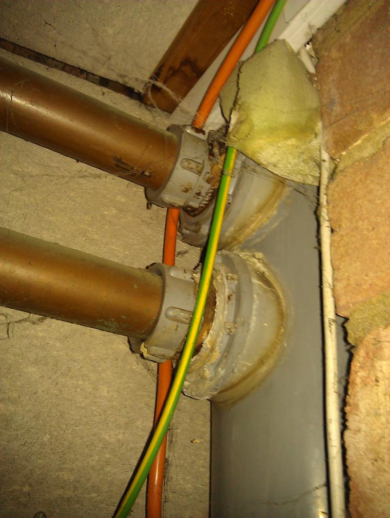

keep the 2 wastes @ the bosses - leave 2 stubs - as you thought - then use McAlpine couplings to adapt to plastic - google it , you`ll see they`re sold @ loads of merchants .
Loads of plastic x copper compression waste fittings available. It will be 11/4" or 11/2" not metric

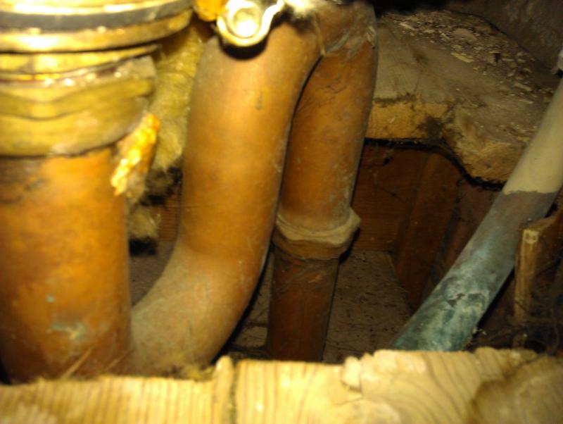

- The copper wastes boss into a 110mm plastic soil stack. The boss seems to possibly be some sort of compression joint but TBH im not sure. The tightening nuts/ring on the lower boss has split. Neither boss leaks. See photo below:

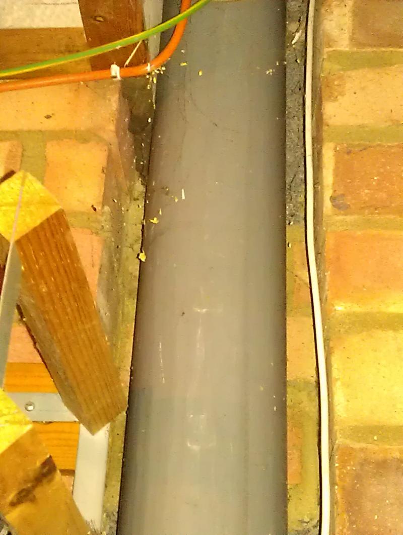

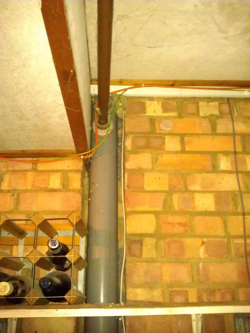

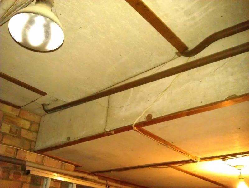

As can be seen from the above pictures the soil stack is recessed into the wall so enclosed on 3 sides - there is probably only a couple of cenimetres either side. Following shows copper waste pipes from bath / sink in garage:

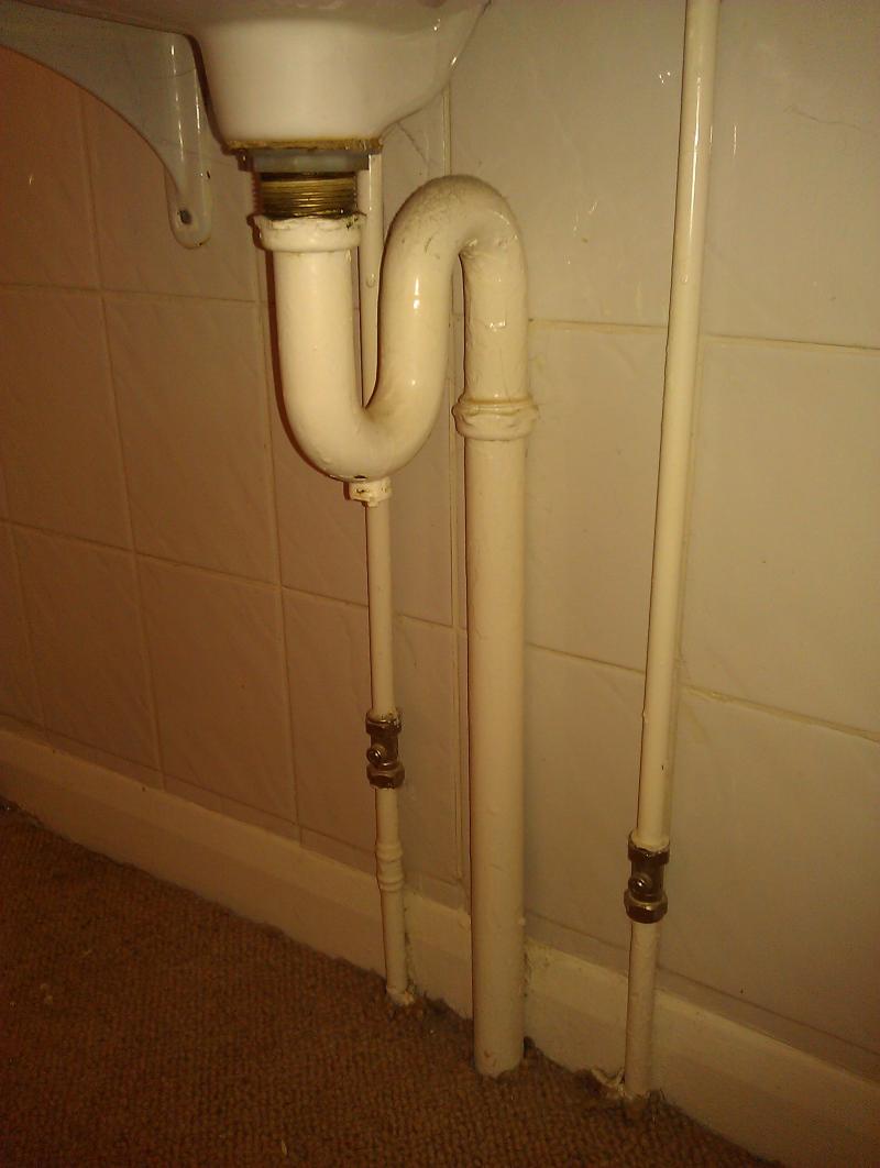

Then we have the sink:
and bath connections:
I remeasured the copper with calipers again tonight and it is definately 34-35mm - this puts it at approx 1 3/8" it is slap bang between 1 1/4 and 1 1/2.
Bath drains fine - on full chat hot and cold it filled the bottom inch or so of the bath then steadied and drained happily with a very very slight rise (1cm max) over 5 mins before I lost pressure having drained the cold water tank in the loft ! So I dont think overflowing will be an issue. Infact the weak link for overflow is indeed the overflow which is the smallest guage of 26mm (external measurement).
So having seen it in its full glorey what options do I have. I am most keen to avoid having to cut and put new sections in soil stack due to the restricted access and knowing that couplings are hard work even with lube. There doesnt appear to be much room for manipulating a slip coupling up and down the soil stack - I suppose it could be gently persuaded with a hammer and something to tap from either side.

It also looks like the copper wastes are only supported by their joints to the bath/sink and then the soil stack - unless there is something i couldnt spot hidden at the moment between the joists.

I would keep as much of the copper as you can because of the supports.
The MacAlpine straight socket is S28M.
The copper is imperial so measured ID and not OD
