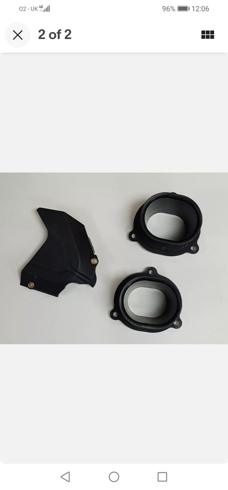

I'm going to make up a throttle body trumpet for my motorbike that will be made up of 2 parts from seperate engines grafted together (likely a mix of glue and fibreglass all tidied up)
I then want to get this part 3d printed so I have it in 1 single finished piece, I've found places online that will quote and 3d print from a supplied 3d design but I've no idea how I get from the physical part I'll make to a 3d design they can use, anybody done this before?

You can scan the part you have created, but if the geometry is fairly simple it's probably easier to build the part from scratch in CAD, ready to be 3d printed.
Because even the best scans needs some manual tidying up.
I wouldn't have a clue where to start in cad so some sort of scan would probably be the way forward?
Is the scanning kit something the printing company would have or can it be done diy?
Getting something printed these days would cost more than 3d i would imagine.
It depends very much on the geometry. It's actually more likely that scanning will cost more than printing.
A throttle body trumpet is a very simple geometry that once you have some basic measurements for would take about 5 minutes in CAD.

This is all in the planning stage, I'm still gathering parts and working out the ins and outs, hence this thread.

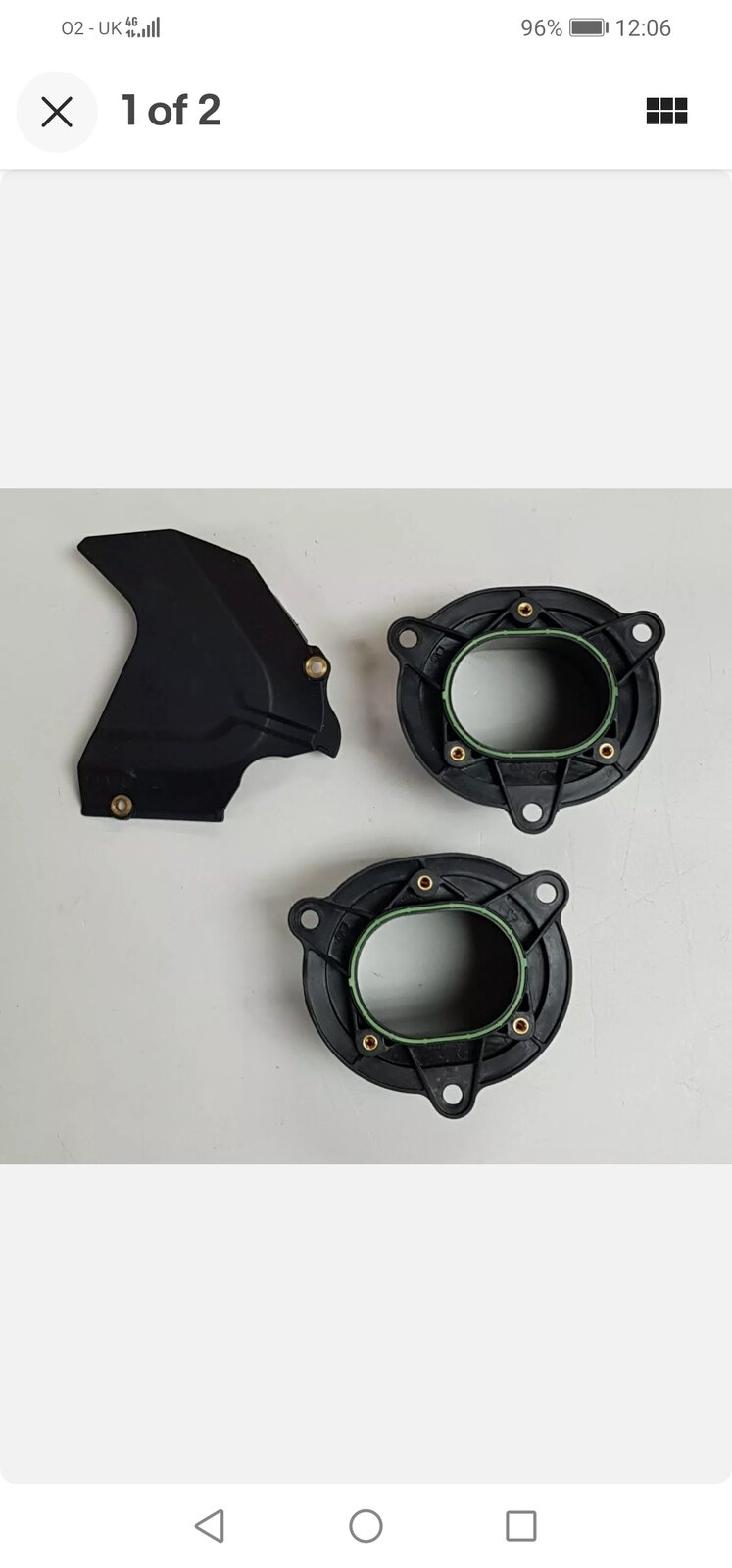

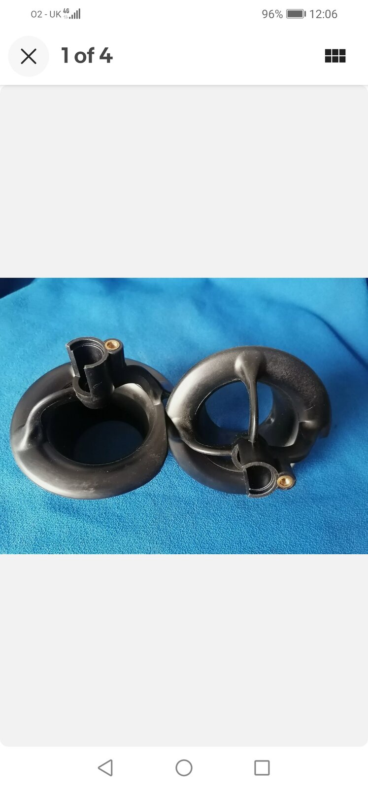

On the right in the above photos is 2 ducati 1098 throttle body trumpets
The above is a ducati 999 throttle body trumpet, I want to cut off and graft the injector holder from one of the bottom trumpets to the trumpets in the top pictures and then have it 3d printed as one piece

This is purely to give me a better solution for holding the injector, currently I have a 90 degree bent piece of steel with the injector slot cut out in it riveted to the side of the trumpets, works perfectly fine bike dyno'd at 160bhp but I'm redesigning the airbox to make a more elegant solution and this will be part of it.
I've zero interest in making money out of it, if I can get something that works I'd likely post the design on the ducati forum I use so others can get them printed
