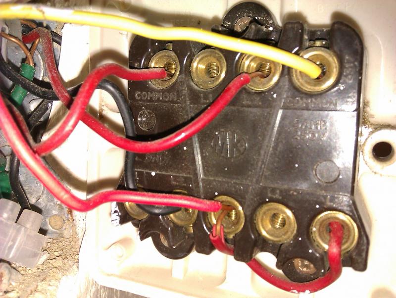

Hi folks,
I have in my hallway a 3 gang 2 way switch the left switch is for the hallway light, the right hand switch powers an outside light and the middle switch is now defunct as it once powered a light in my former car port and has been defunct for many years.
My question is how do I wire a 2 gang 2 way switch from the original 70's wiring thereby tidying things up and there is no further need for 3 switches?
Any help would be appreciated.
A photo of the wiring would help anyone help you here. But from what you have said it just seems that if you buy a 2 gang and just connect the wires to the hall and o/s light the same as they are in the existing switch and make off the spare wires into a 2 way piece of 5a chock block it would be job done
Well, You just transfer the wires to the corresponding terminals of the new switch, if there are still wires in the centre switch put each of these into a separate connector block and tuck out of the way.
Don't forget to turn off the power.
Can you post a picture of the old switch before you disconnect any wires and the new switch.
The terminals may be differently marked and one of the new switches may be upside down in relation to the other which may confuse you.
.........and an important connection (eg a live feed) may be routed through the (now redundant) switch. Disconnecting that may also disonnect other circuits.

OK Turn off the power. Use a multimemter to confirm the power is off (see safe isolation procedures in the WIKI)
First off. The rred wire that is in the middle top (L2) connection. Put that in a piece of inslated "choc block". Its not needed any more.
Remove the red link at the bottom right that goes between the COMMON and L2 terminals. Put the red wire that was in the middle COMMON terminal into the right hand L2 terminal.
Turn the power on and check all the circuits still work.
Now all you have to do is to turn the power off and move the wires over onto the new switch.
I see the picture.
Remove the wire from the top L2 and put in a connector block.
The remove the wire from the bottom common, and also remove the link from here and the righthand botom L2.
Discard the link and put the wire in the righthand bottom L2.
Transfer this wiring to the new 2 gang switch. If it is a brand new switch you will probably have to use the common and L1 terminals.
This will depend on the make of the new switch.

Thank you all very much for your very helpful input to my query ref: 3G to 2G 2-way switch wiring. It worked like a dream.
